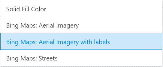

The following Bing services are available in the list:
  • Solid Fill Color – The globe is displayed with the color that is defined in the viewer Presentation options panel
  • Bing Maps: Aerial Imagery – The globe is displayed with the Bing aerial imagery
  • Bing Maps: Aerial Imagery with Labels – The globe is displayed with the Bing aerial imagery plus the labels that give more contextual information
  • Bing Maps: Streets – The globe is displayed with a road map
These layers above are present in the list as default, out of the box. The user doesn’t have to add them manually.
The visibility of the layer can be changed by toggling ON and OFF.
The transparency of the Base Layer can be modified by using the slider bar.

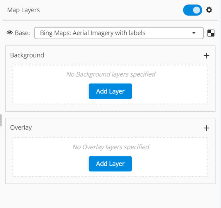

Background and Overlay layers
The user can add layers in the Background section and/or Overlay section. Users can drag a layer from one section to the other, as well as order the layers within a section.
Background section – The layers added to this section will be displayed over the Bing layer but behind the iModel.
Overlay section – The layers added to this section will be displayed on top of all layers, including the iModel.

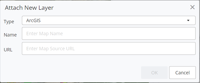

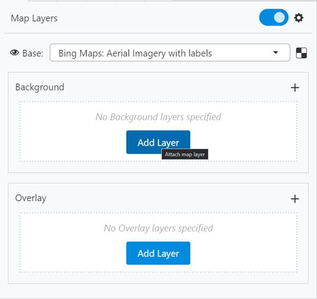

Add new layer
To add a new layer, click on the “Add Layer” button or on the “+” sign.
Attach New Layer dialog
Type
Select the type of service. The Background and Overlay sections allow referencing three types of GIS data:
  • ArcGIS Map Service (OAuth2 authentication has been implemented in the Map Layers widget API. This functionality is not yet available in Design Review Application)
  • WMS
  • WMTS
 Name
Type a name. Use a name that is relevant so that any user who wants to attach the layer can easily know which layer he is attaching.

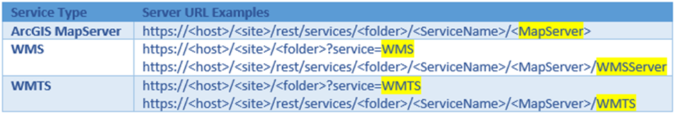

 URL
Type or copy the URL of the server to attach.
Here are some examples of URLs that should be used:

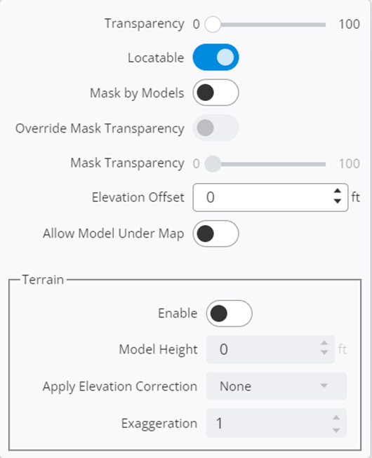

Settings dialog
Different settings are available in the Map Layers Settings panel.
Transparency
Use the slider to apply transparency on all layers from the Map Layers widget.
Locatable
Toggle ON this option to see the information and coordinates of the location pointed by the cursor on the Bing layer.
Mask by Models
Toggle ON this option to mask the map layers contained in the view. The iModel and the reality data serve as a clipping element. This can be useful when the iModel contains elements located under the ground. Enabling the mask allows one to see the underground portion of an iModel. When turned off, the map layers block the view.
Elevation Offset (m)
Use this option to adjust the Map layer's elevation to align with the iModel whenever necessary.
Allow Model Under Map
Use this option to allow the display of the underground section of the iModel under the map layers.
By default, the map layers are displayed in the background, completely behind the iModel and reality data, so that the user sees the model in its entirety, even the parts that should be displayed under the ground.
Terrain
The Terrain section contains options related to the display of the Cesium terrain layer.
Toggle ON the "Enable" option to activate the Cesium terrain layer and have a 3D view of the terrain surrounding the area of the iModel.
Model Height (m)
Use this option to adjust the terrain elevation so that it fits the model elevation.
Apply Elevation Correction
Sometimes the iModel is not displayed at the right elevation in Design Review. Most of the time this happens when the input design file was created with the wrong vertical datum; Ellipsoid instead of Geoid. So when the user turns ON the Cesium terrain, the elevation is incorrect. Another case is when the user has drawn his design at the right location but on a random elevation.
To correct the elevation
  • None - Use this option when no correction is required. This is the default option.
  • Geoid Separation - Use this option when the iModel has been created with the wrong vertical datum (Ellipsoid instead of Geoid).
  • Terrain Elevation - Use this option to apply a correction with the Terrain Elevation. You can play with the Model Height option to adjust the elevation with more accuracy.
Exaggeration
Use this option to exaggerate the elevation of the Cesium terrain.
