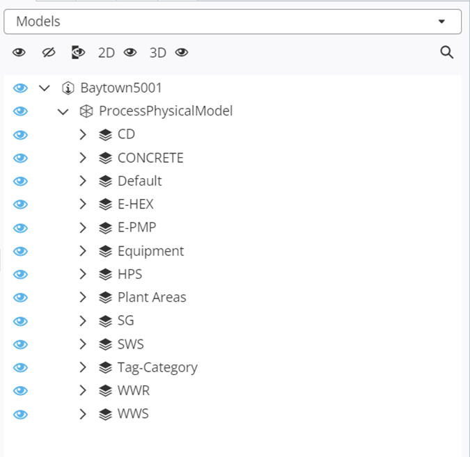

The Tree View widget allows you to visualize all types of 3D CAD/geometry/BIM models present in your digital twin.
Models
The models are listed in a hierarchical fashion so that you can show or hide the ones you need.
You can use the buttons Show All, Hide All, and Invert to display the exact set of elements that you are interested in.
To know more about how to ingest these models into your digital twin, refer Configuring as-designed models section.

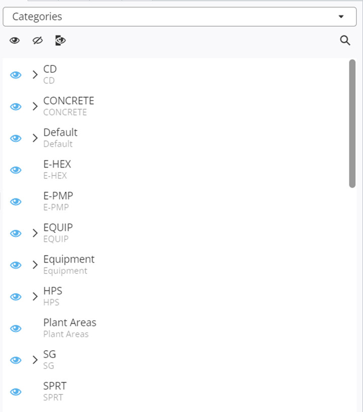

Categories
The categories tab allows you to control the display of elements based on the category they belong to. Instead of selecting each element individually in the Models tab, you can turn on/off the display of 1000s of elements by quickly selecting their category and turning its display on or off.
You can use the buttons Show All, Hide All, and Invert to display the exact set of categories that you are interested in.
