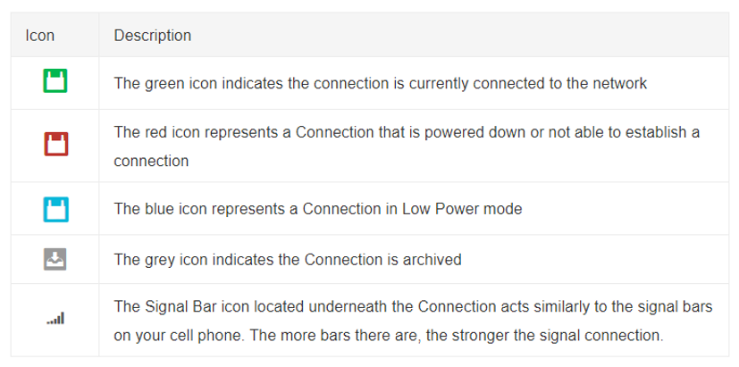

Connection Status
The status indicators are located next to the connections in the Connectivity Module.
Note: In some cases, API or FTP connection color status may be misleading. Best practice is to verify connection status of these connections by looking at the sensors "Last:" timestamp on the right side of the Connectivity page.

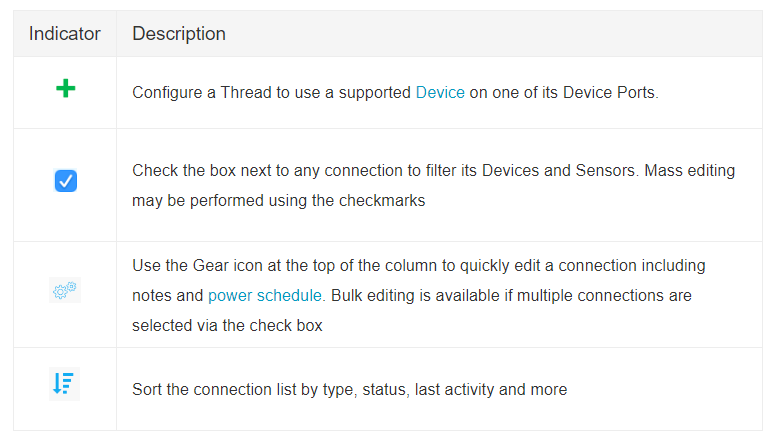

Connection Functions
Connection functions are located either next to the connection or at the top of the connection module.
Please check the proper sections for more information about specific connections such as Threads, Strands, and third-party hardware.
