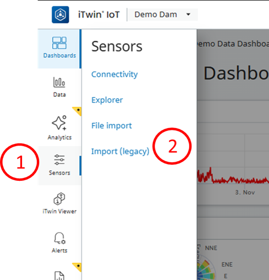

How to Import using the Import (legacy) tool.
1. Navigate to the Sensors module on the left side of the screen.
2. Select Import (legacy) from the available options.

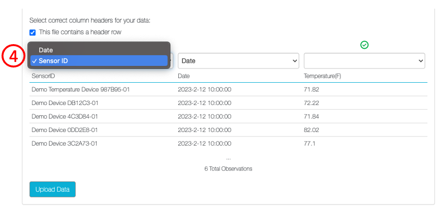

4. Select the correct column headers for your data: Every sensor will have certain fields that are required for data upload. These are the raw data values that make up a data point for that particular sensor. Sensor name and date are required for every sensor, the rest will depend on the sensor type.
Note: If the file has a header row containing titles, be sure to check the "This file contains a header row" box.
Match each column with the field it represents. Establish the column that is the sensor ID (Name) first. This will then search the column for different sensors and list them out to be mapped to iTwin configured sensors.

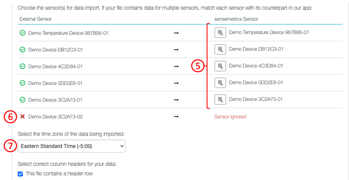

5. Map Sensors: Each sensor in the .CSV or .DAT file will need to be matched to a sensor in iTwin or excluded from the import.
Every sensor name listed in the file will now be shown in the "External Sensor" column. Click the  Sensor Selection Tool to choose which iTwin configured sensor the data will be appended to.
6. If you choose to exclude data from a sensor listed in the .CSV file, click the   to turn it into an   and it will not be uploaded.
7. Specify the timezone the data was recorded in. This will ensure the time stamp of each reading is correct.

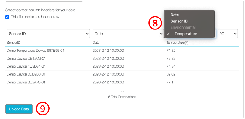

8. Finish mapping columns: Now that iTwin knows what type of sensor you are importing, it will autofill the metrics that are required to create data in the database. Map each column to the metric it represents and choose the units it is recorded in.
Make sure to have a column selected for every field required to create that particular type of sensor.
Any extra columns within your file that do not match the required metrics will need to be excluded. Click the  above the column to turn it into an   and exclude it.
9. Upload Data: Once every sensor has been mapped to one in iTwin and every column entry has been identified, you are now ready to upload. Select the   button and a message will appear notifying you when the import was successful.

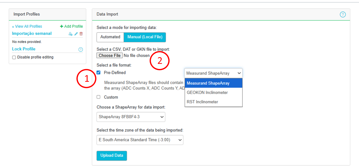

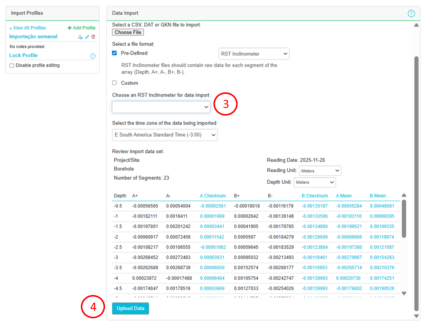

Pre-Defined Format
Use the pre-defined format to upload specific data, CSV, DAT or GKN files provided by either a Measurand Shape Array, an RST Inclinometer or a Geokon Inclinometer. The workflow is similar to the custom format import, but the data columns are automatically configured according to the file.
1. Check the Pre-Defined format box.
2. Click the  button to open a file explorer and select the desired CSV, DAT or GKN file. The file will then be pre-loaded and previewed at the bottom.
3. Choose an existing or create a new device to receive the imported data.
4. Hit Upload Data.

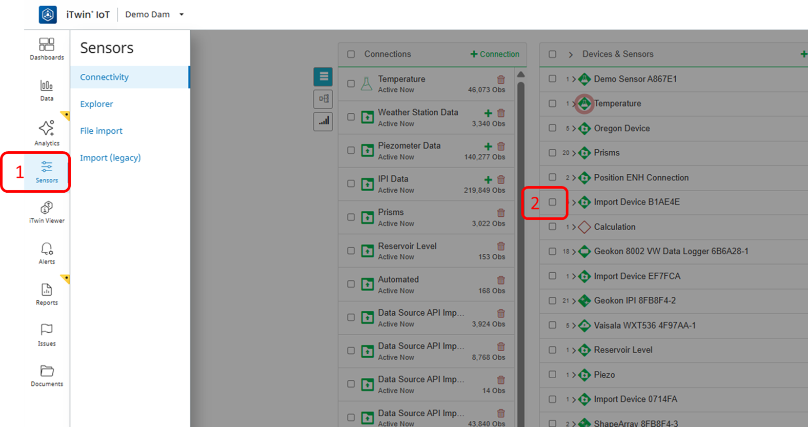

1. Connectivity - Navigate to the Connectivity under the Sensor module on the left of the screen in the Module navigation bar.
2. Sensor Selection - Find the sensor to upload an observation to from the Devices & Sensors portion of the Connectivity module. Select the sensor by clicking on the name.

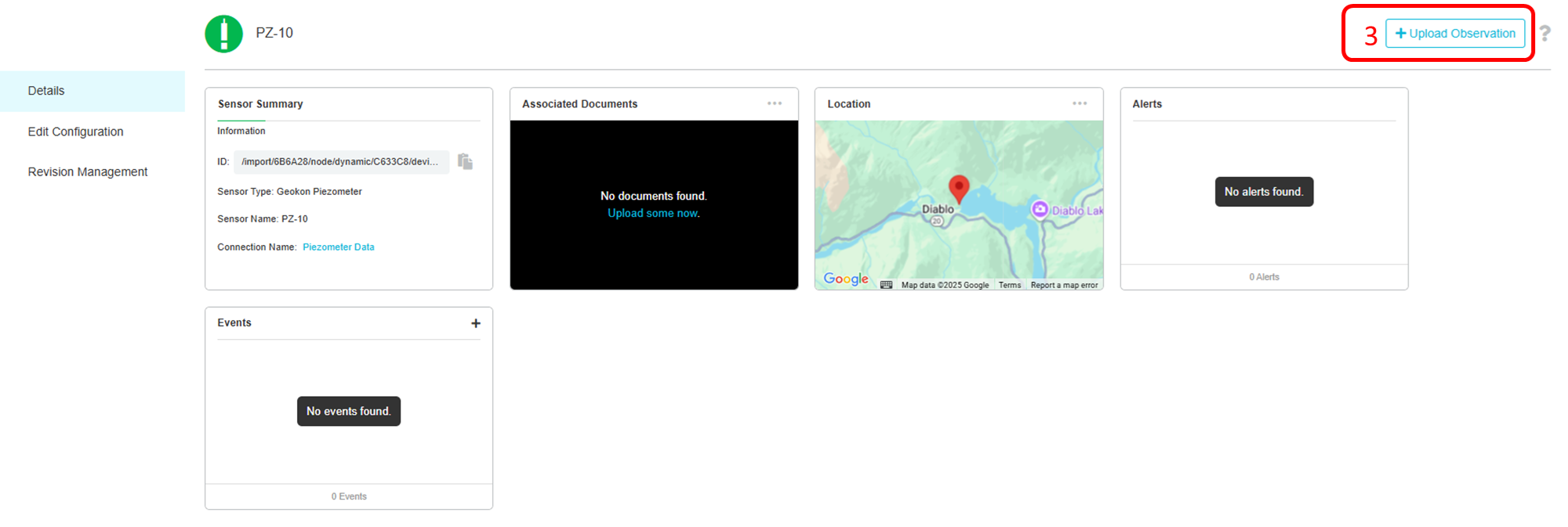

3. Upload Observation- In the upper right portion of the Sensor Details page, click on the "+Upload Observation" icon.

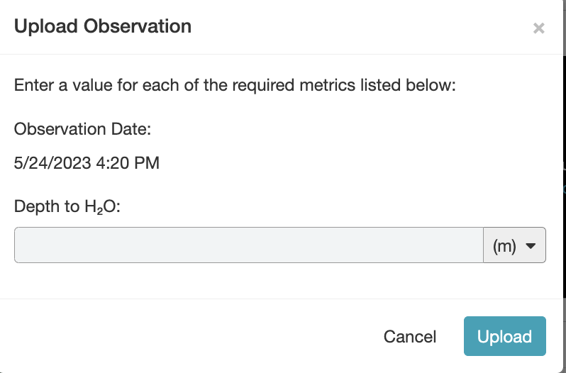

4. Observation Input- A pop-up window will open, allowing the user to input an observation for the sensor in a raw data format. The date stamp of the observation will be pinned to the time of input on the user's computer. The raw data metric can be changed, if applicable, on the right side of the input window. When the data has been input, click "Upload". The data will be available for viewing in the Data module.
