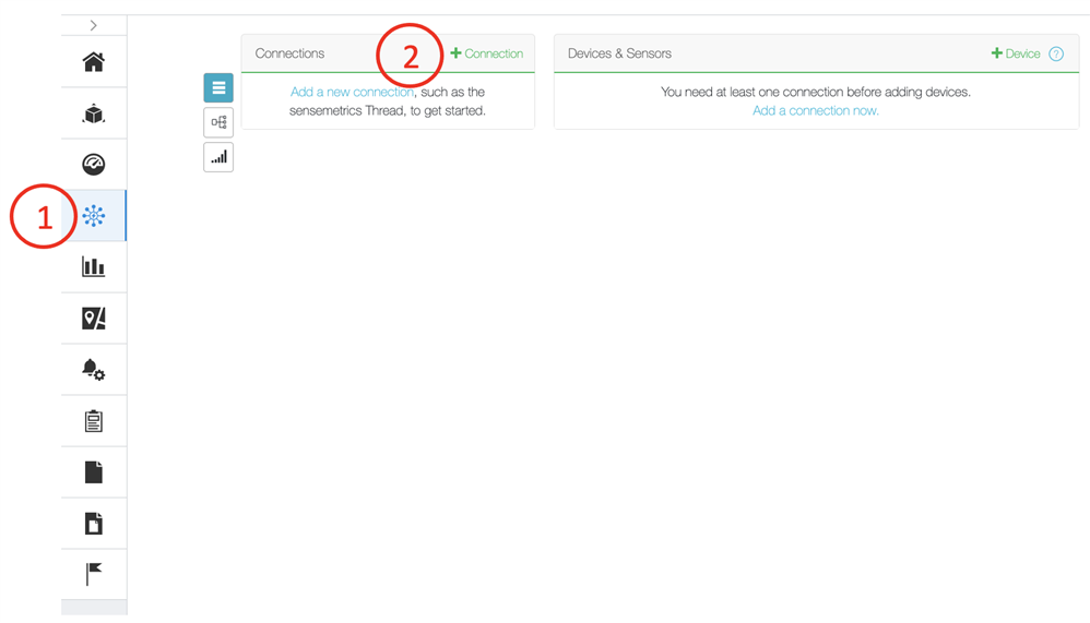

1. Connectivity Page- Navigate to the Connectivity Module.
2. Add Connection- Press the "+Connection" button in the Connections Column

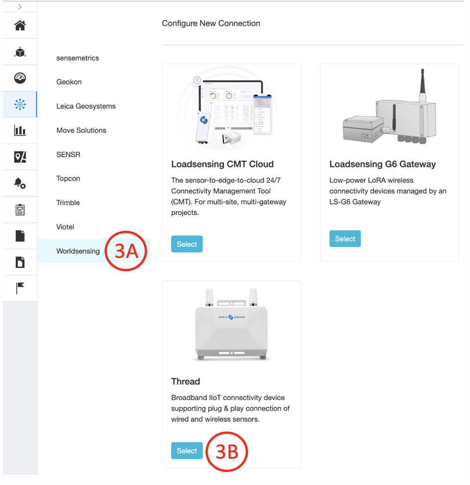

If adding a Worldsensing Thread:
3A- Select Worldsensing on the left side options bar.
3B- Click the "Select" icon below the Thread symbol.

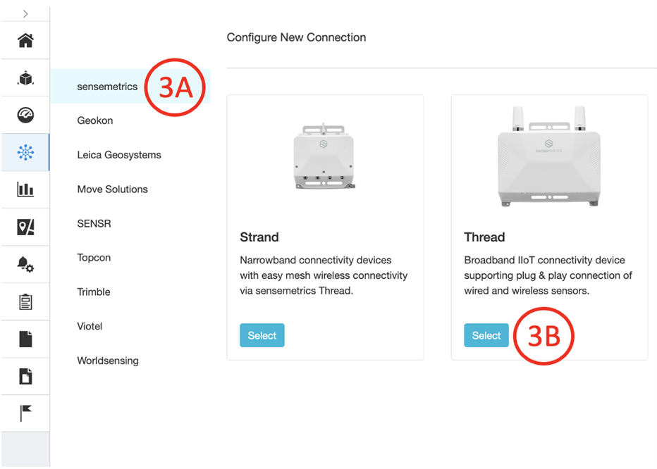

If adding a Sensemetrics Thread:
3A- Select Sensemetrics on the left side options bar.
3B- Click the "Select" icon belwo the Thread symbol.

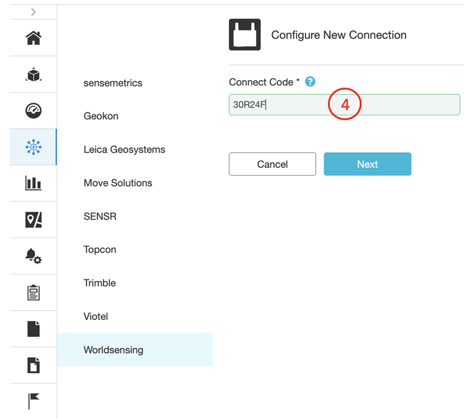

4. Entering Thread Connect Code

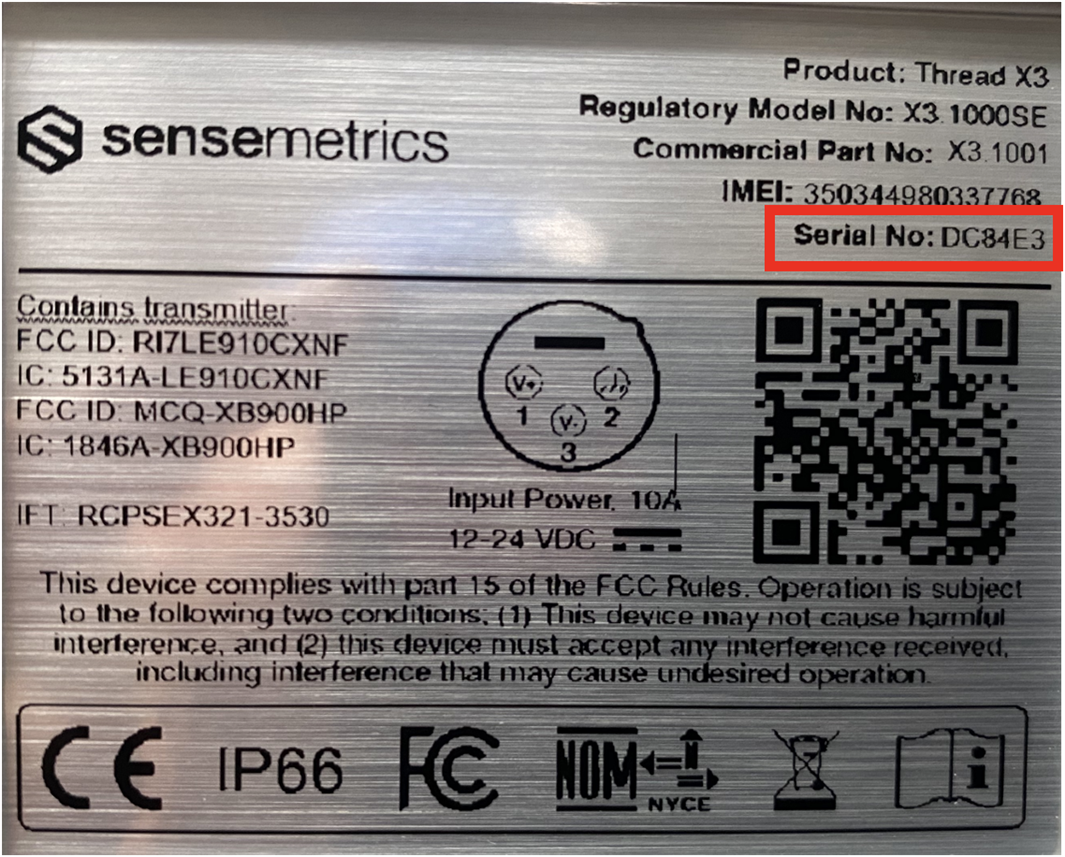

Find and enter the 6-digit Connect Code of the Thread. This code is located on the silver label on the back of the Thread. The location is highlighted in the image below. Click "Next" after entering the Connect Code.
Congratulations, you have successfully added a Thread to the asset. Sensor devices can now be plugged into the Thread and added to the iTwin IoT application.
