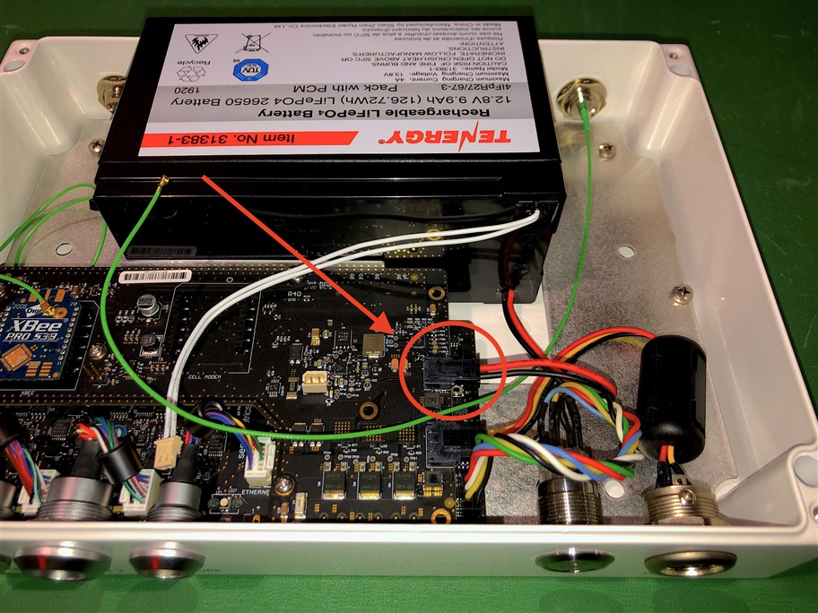

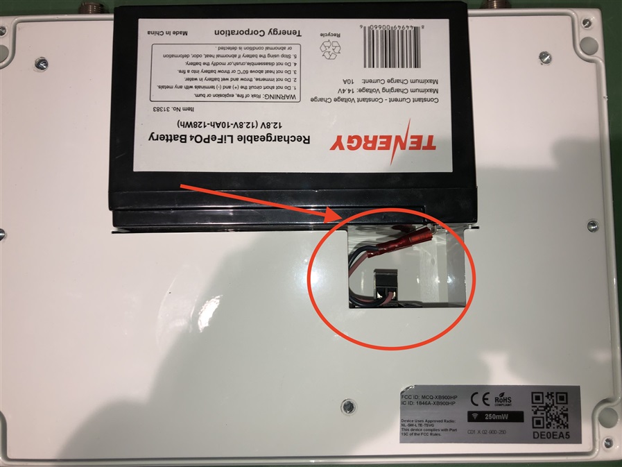

Step 3: Disconnect the Internal Battery Within the Chassis
NOTE: Here we see the physical differences of Thread model. If your model Thread is not pictured, please contact Support for further assistance.
Option 1:
  • Disconnect the internal battery from the junction found in the middle of the chassis
Option 2:
  • Disconnect the red & black cable coming from the battery.
