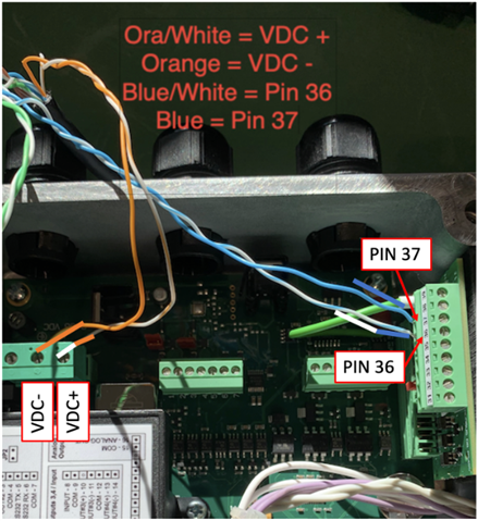

Wiring the Sensor
The Thread connection cable will need to be wired into the Badger Meter in order for the Badger Meter to be connected to a Thread. The below instructions will walk the user through the wiring process.
The below image illustrates the wiring for the M-2000 flow meter.

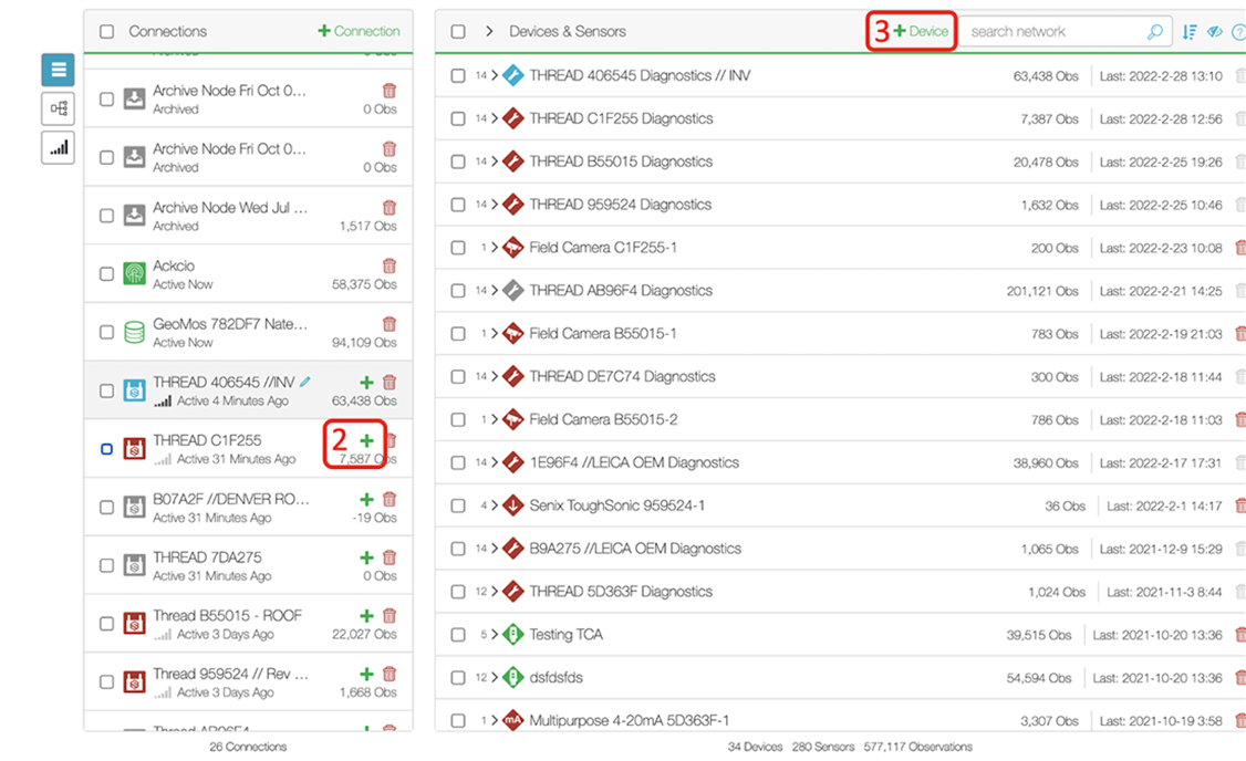

2.  Press the   button directly on a THREAD to add a Device to it. If your THREAD does not appear here, you may still need to Add Your THREAD as a Connection.
3.  You may also add a device from the     button in the Devices & Sensors Section.

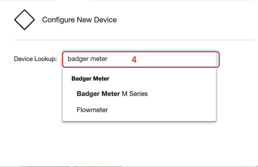

4.  Begin by typing in "Badger Meter" and selecting "Badger Meter M Series" once it autocompletes in the search box.

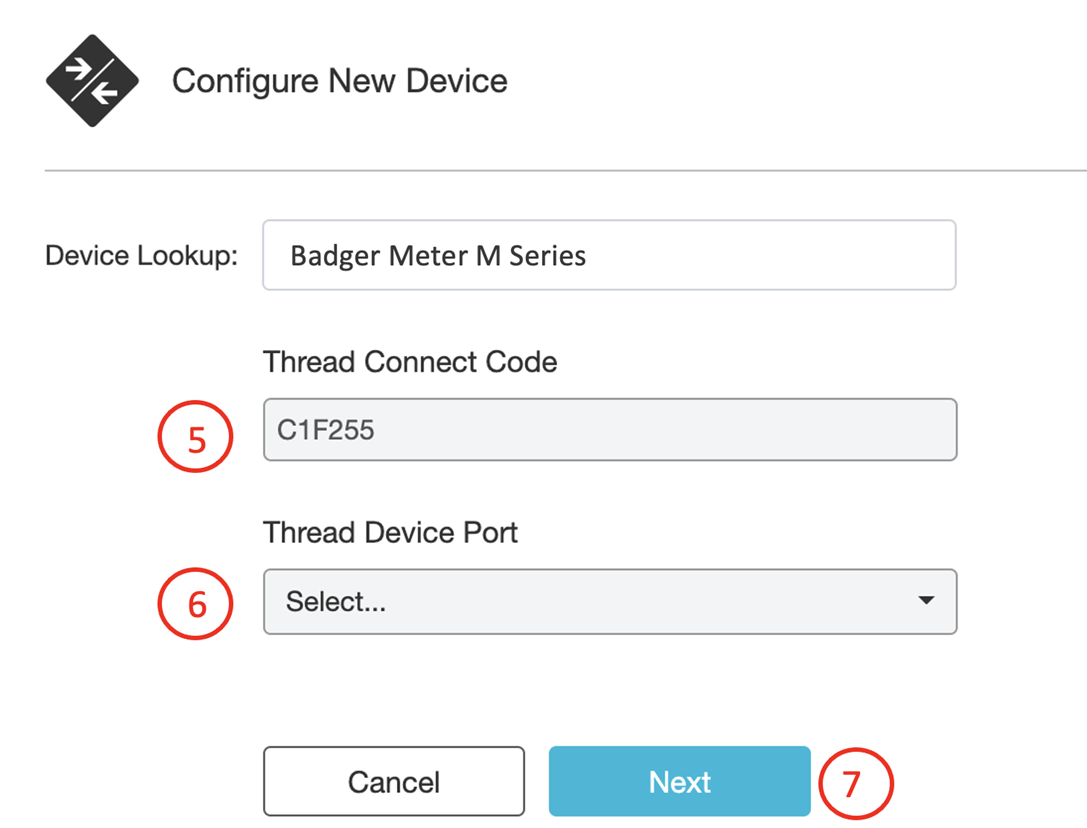

5.  Type in the Connect Code of the THREAD that the Device is connected to. It will already be pre-filled if the   button on the THREAD was used in step 2.
6.  Select the THREAD communication port that the device is plugged into, Device 1, 2, or 3.
7.  Click the Next button in order to save settings. The front display on the device should power up and LEDs should be visibly lit on the motherboard. Navigate to the Main Menu > Communication > Port B Settings of the M-2000 Flow Meter.

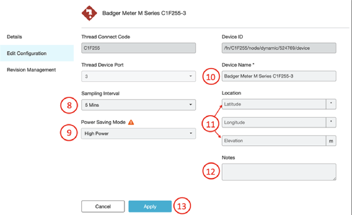

Edit Configuration
The next page you will be directed to allows the user to edit certain settings and sensor information.
8. The user can change the sampling interval for the sensor with options between 60 seconds-60 minutes.
9. The user can select how the Thread will power the flow meter. The options include High Power and Low Power. High Power mode enables the device to be powered at all times, allowing accurate cumulate readings. Low Power mode powers the flow meter when the Thread is awake and following Thread Schedule. When the Thread wakes up, the flow meter will be powered to take a reading.
Note: Cumulative metric accuracy may be impacted by the Low Power setting.
10. The user can change the sensor's name which will become the sensor name displayed across the application.
11. The user can input the sensor's location and elevation. This location information will allow the sensor to be displayed within the Spatial mapping feature.
12. Notes can be added here.

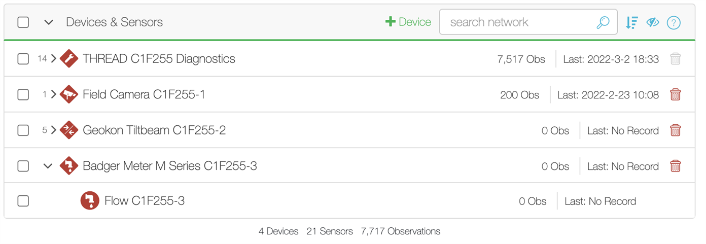

13. After changes have been made on this page, click the apply button to save the Sensor Configuration changes. After saving, the Sensor will now be displayed in the "Devices & Sensor" window on the Connectivity page.
