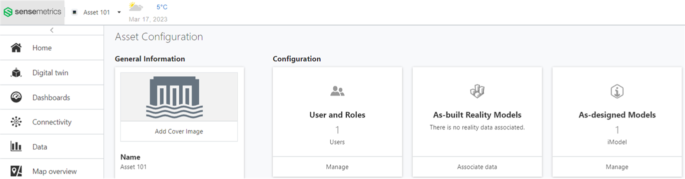

Open the Configure page and click on the tile As-built Reality Models.

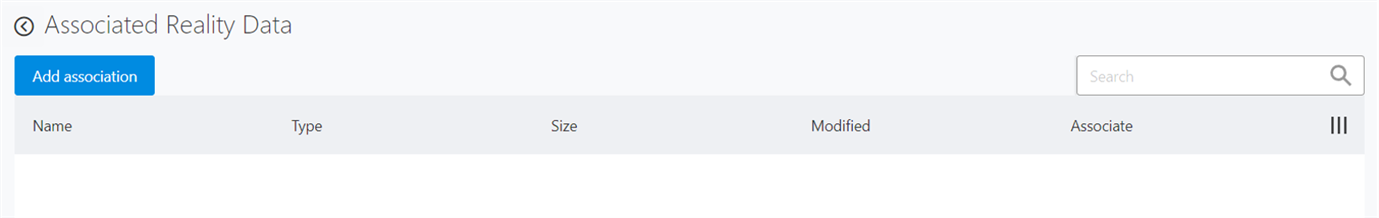

In the next page, click on Add association button.

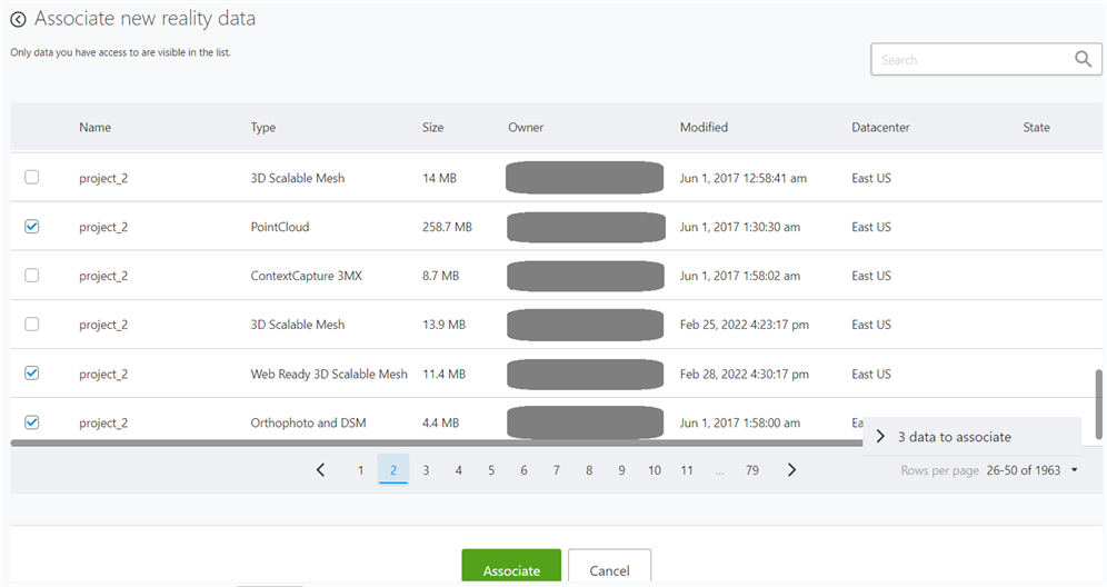

You will be presented with all reality data from your organization that you have access to. Select the ones that you are interested in using in your asset and click on Associate button. The selected reality data will be associated to your asset.
