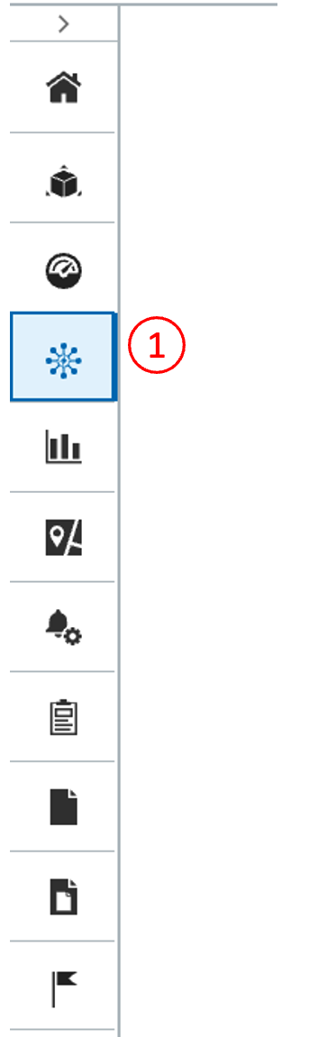

1.  Navigate to the Connectivity Module.

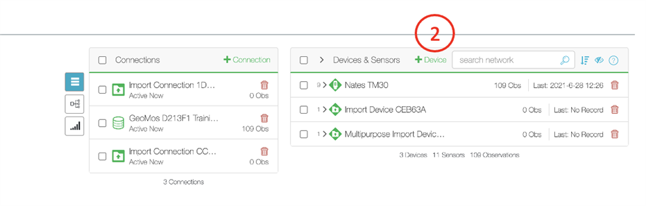

2. Click the "+Device" icon.

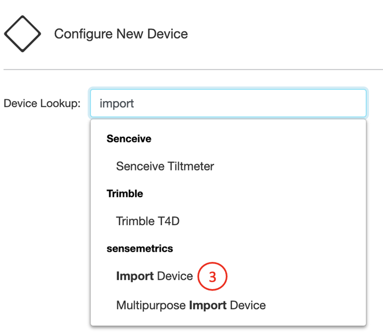

3. Within the Device Lookup window, begin typing "Import Device". When the dropdown options begin to populate, select "Import Device".

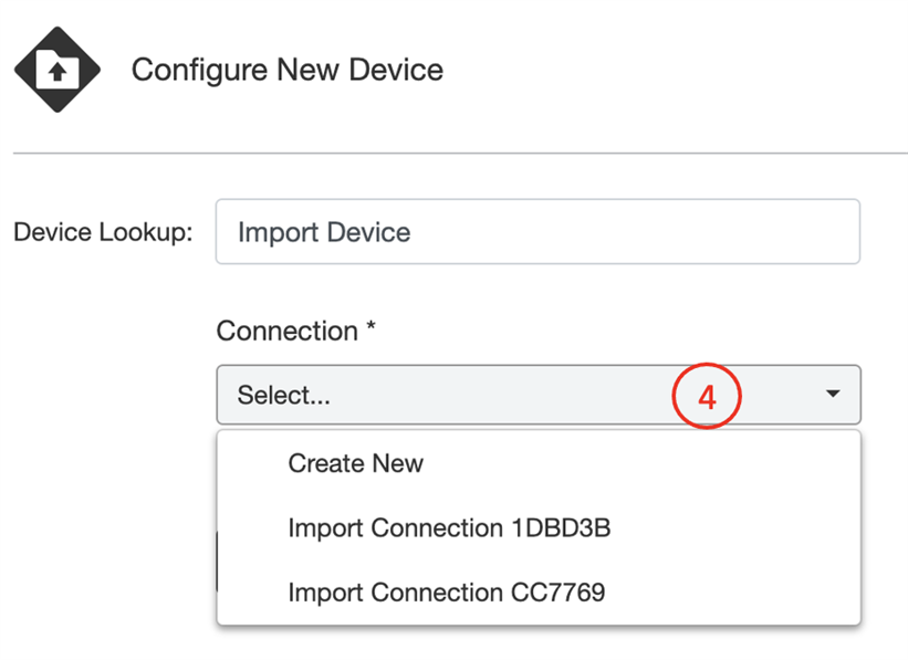

4. A Connection selection dropdown will appear in the next page. If no previous Import Connections have been made, the user will be required to "Create New", and a new Import Connection will be made. Previously created Import Connections can also be selected, which can aid in Import Device management if multiple Import Devices are being utilized in the asset.

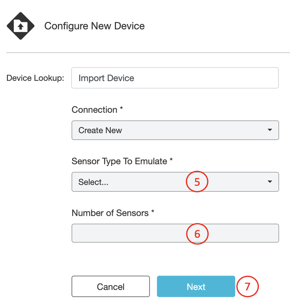

5. Once a Connection is selected, two additional dropdowns will appear. The first dropdown allows the user to select which type of sensor the Import Device will emulate.
6. Next the user can select the number sensors of the selected emulation type that they would like to create.
7. Once configuration is complete, click "Next" to save those selections.

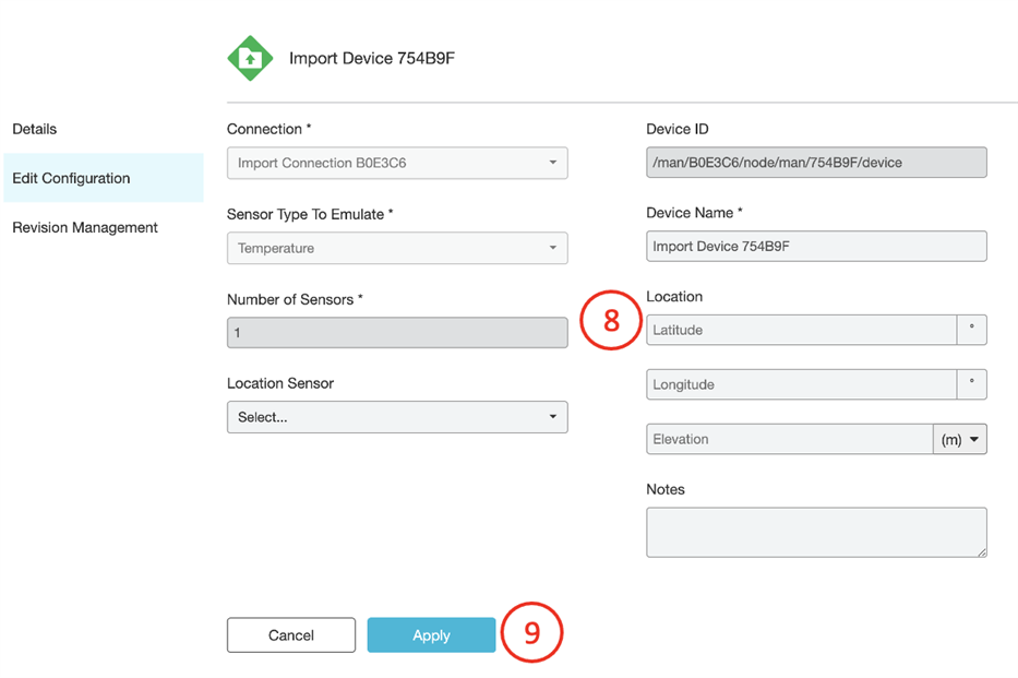

8. The user will then be directed to the Device "Edit Configuration" page, where items like Device Name, Location, etc. can be configured.
9. Click "Apply" to finish the configuration.

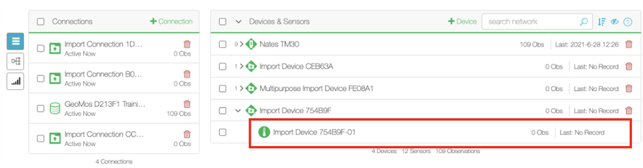

The configured sensor or sensors will then be displayed under the device, as highlighted below.
