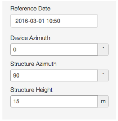

Navigate to Configuration > Sensors > and select the sensor you wish to configure. The permanent Metric parameters will show up here as shown in the figure below. The values set here will be applied to the sensor throughout the entire app.

Reference Date
A reference date will become available when a sensor uses delta calculations. This is most common with any type of Position or Tilt measurement. The reference date will specify the first date used when calculating the amount of change within a certain time frame.

Sensor Azimuth
Sensor Azimuth will become an available parameter when using a sensor that measures position or tilt but does not automatically realize the North/East directions.
In order for the Northing and Easting calculations to represent actual Northing and Easting, you will need to specify the sensor azimuth.
Structure Azimuth
Structure azimuth will become an available parameter when using a sensor that measures Position. This field will allow you to orient the Transverse/Longitudinal Axis in any desired direction. It is useful for finding movement in the direction of a specific structure or any point of reference.
Structure Height (Gauge Length)
Structure Height is a field that is available for tilt sensors.
Enter the Height of the structure from the base to the top of the structure. This will use a trig calculation with the Tilt X/Y angle to create an X/Y Vector at the top of the structure.
