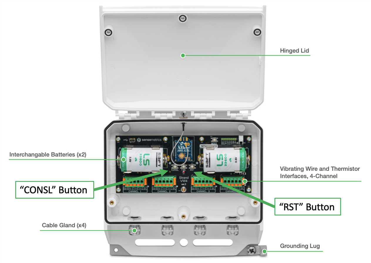

Step 1: Open Strand and Remove Batteries
Open the Strand's front cover by unscrewing the three Torx screws on the front cover. The Strand will appear as illustrated in the image below. Remove both batteries from their retaining clips. This is a good time to check the batteries or replace the batteries as needed. Please note that Strands can only use D-cell Lithium batteries.
Step 2: Discharge Remaining Power
Hold down the "CONSL" button in the middle-left side of the circuit board. While holding down the "CONSL" button, repeatedly press the "RST" button on the middle-right side of the circuit board 10-15 times. The illustration above highlights the location of these buttons.
Step 3: Install Batteries
Take note of the polarity signs on the circuit board. Ensuring proper polarity direction, install the new or existing batteries back into their retaining clips.
