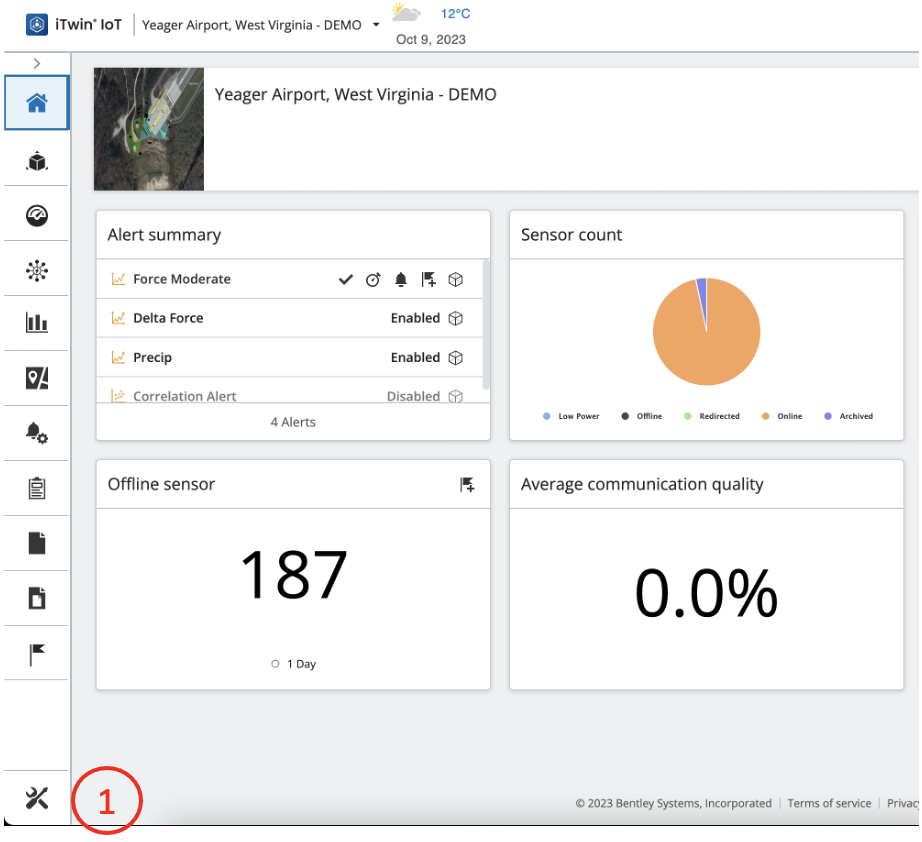

1. Navigate to the Asset that data will be pushed to in iTwin IoT. From any page, click on the "Configure" icon in the lower left side of the page.

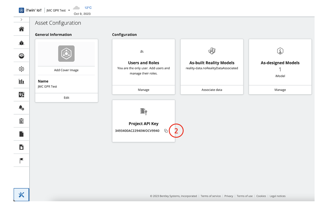

2. The user will be directed to the "Asset Configuration" page. The API key will be available within a tile on this page. The API key can either be highlighted and copied, or the "Copy to Clipboard" button will save it for pasting in future steps.

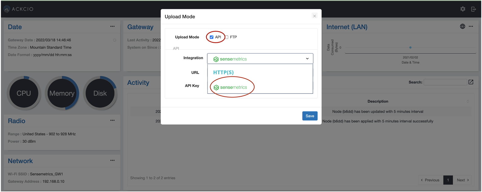

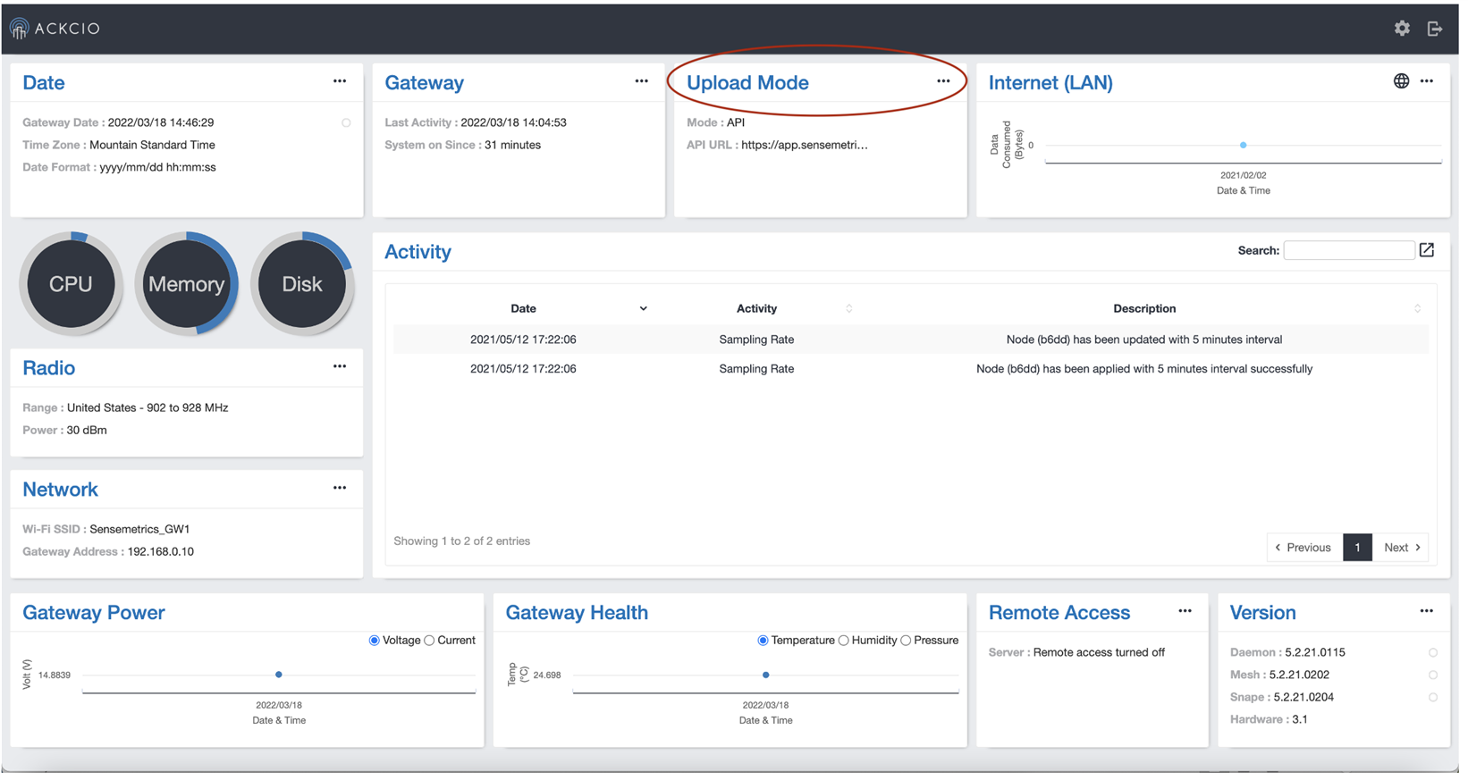

Navigate to the Ackcio setup application. Within the Ackcio window, click on the three dots next to "Upload Mode" in the middle of the screen.
In the upload mode popup window, select the "API" check box, select the Sensemetrics logo in the "Integration" dropdown.

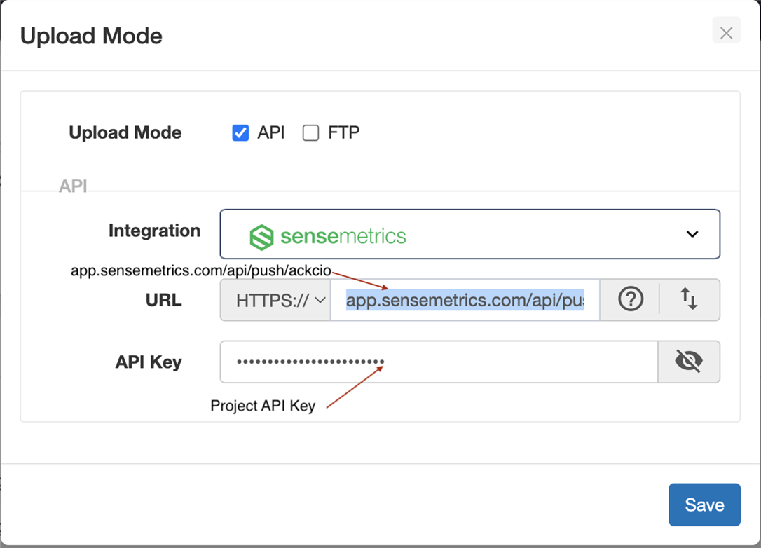

In the URL box type the following:
app.sensemetrics.com/api/push/ackcio
Input or paste the API key retrieved in the previous section into the "API Key" input box.
Click the "Save" icon.
