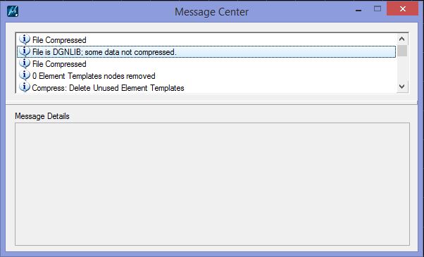

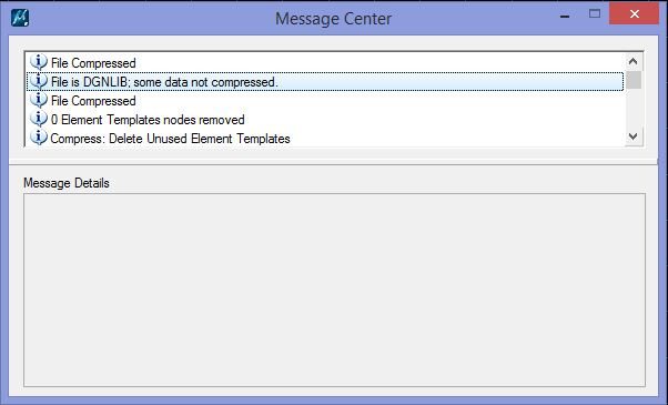

There are various unused Line Styles, Dimension Styles, Text Styles etc that are wanting to be removed from a Design Library (DGNLIB). When using the Compress Options tools an error message is displaying in the Message Centre "File is DGNLIB; some data not compressed".
Since the release of MicroStation V8 XM Edition the ability for the Compress Options tools to purge unused data resources within Design Libraries (DGNLIB) has been removed. It is suggested to use the DELETE UNUSED key-ins to perform this operation.
