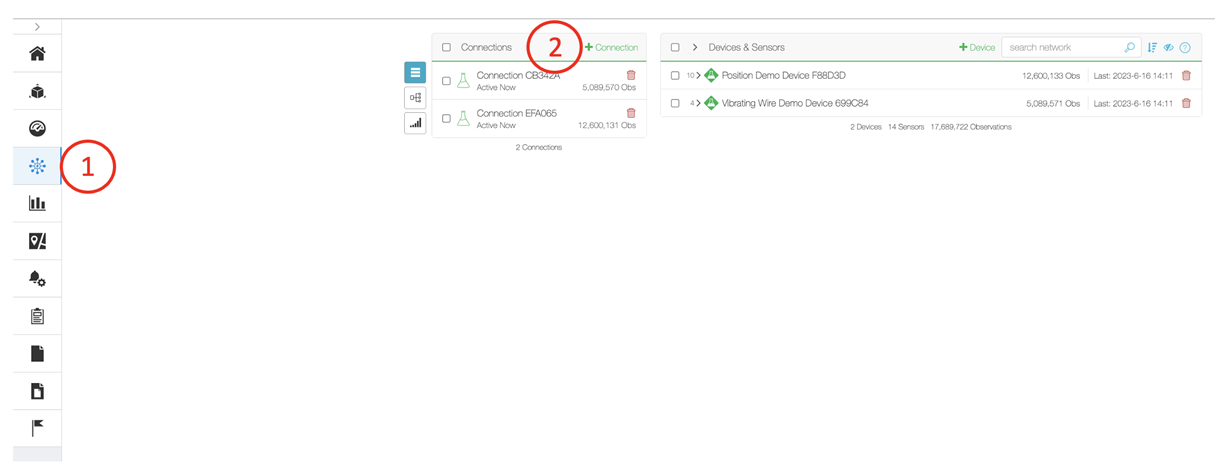

1. Within the iTwin IoT application, begin by navigating to the Connectivity Module.
2. Click on the "+Connection" icon.

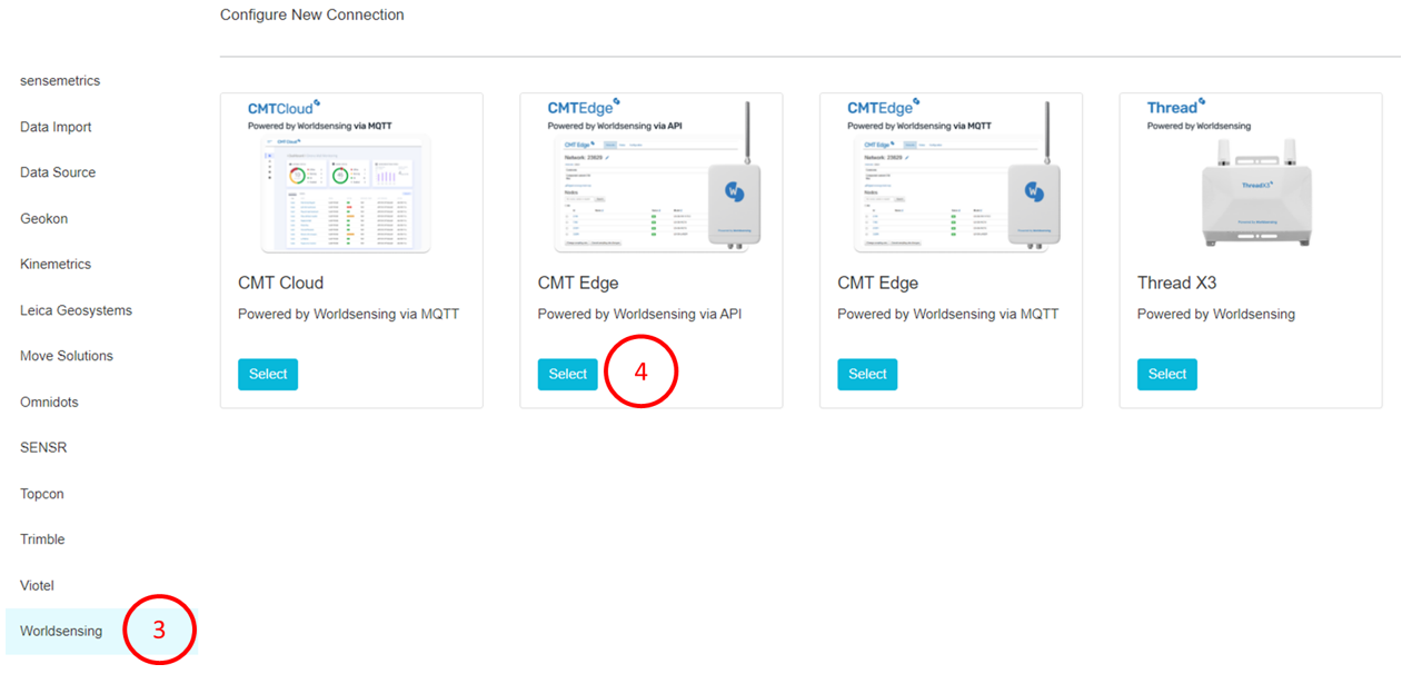

3. Select Worldsensing from the available Connections list on the left sidebar.
4. Click the "Select" icon on the Loadsensing G6 Gateway cloud tile.

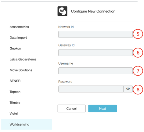

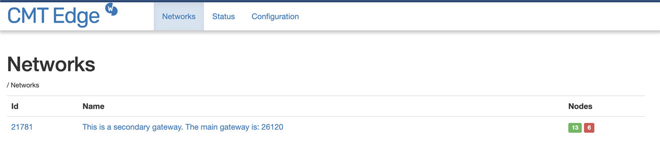

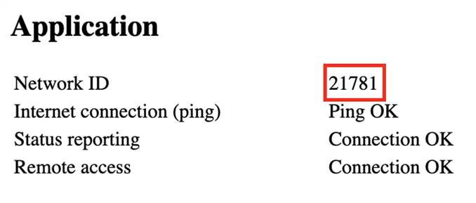

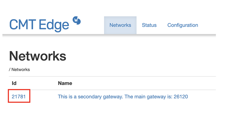

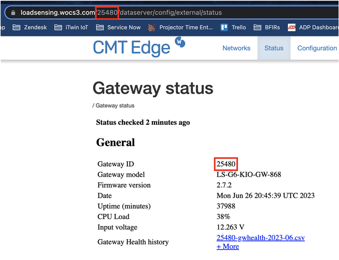

5. Network ID- Input the network ID found on the Networks page (image 1) or on Status page (image 2) of the CMT Edge application.
6. Gateway ID- Input the Gateway ID, which can be found in the URL or on the Status page of the CMT Edge application.
7. Username- Input your CMT Edge username used for logging into the application.
8. Password- Input your CMT Edge password used for logging into the application.
Click "Next" once all information has been input.

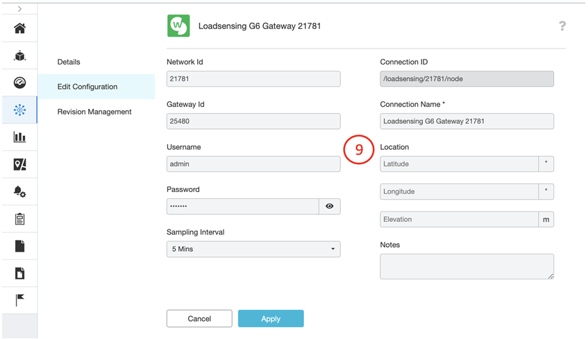

9. The next page will be the Edit Configuration page for the connection. Standard configurations are available. After configuration changes have been made, click "Next".

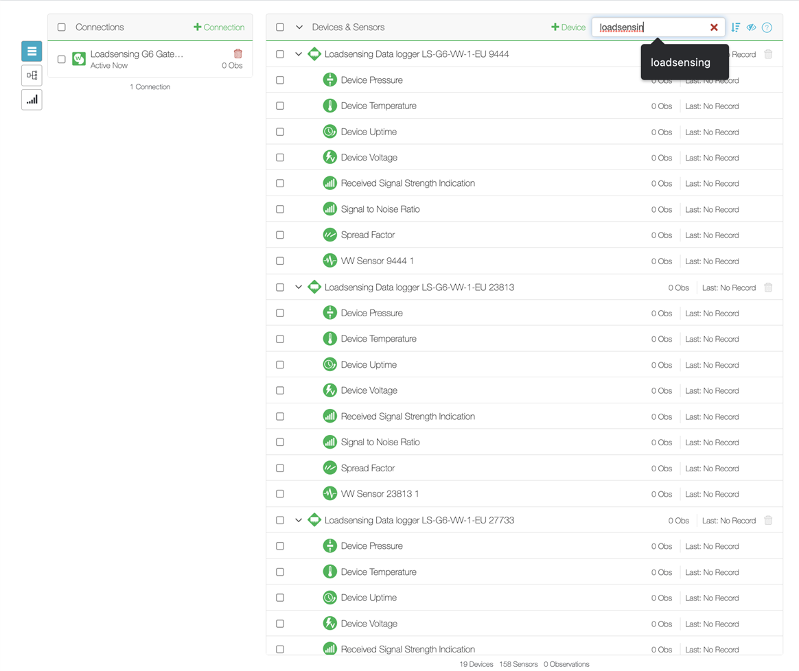

Once complete, Devices and Sensors will begin populating within the Connectivity module and observations will begin streaming from CMT Edge.
