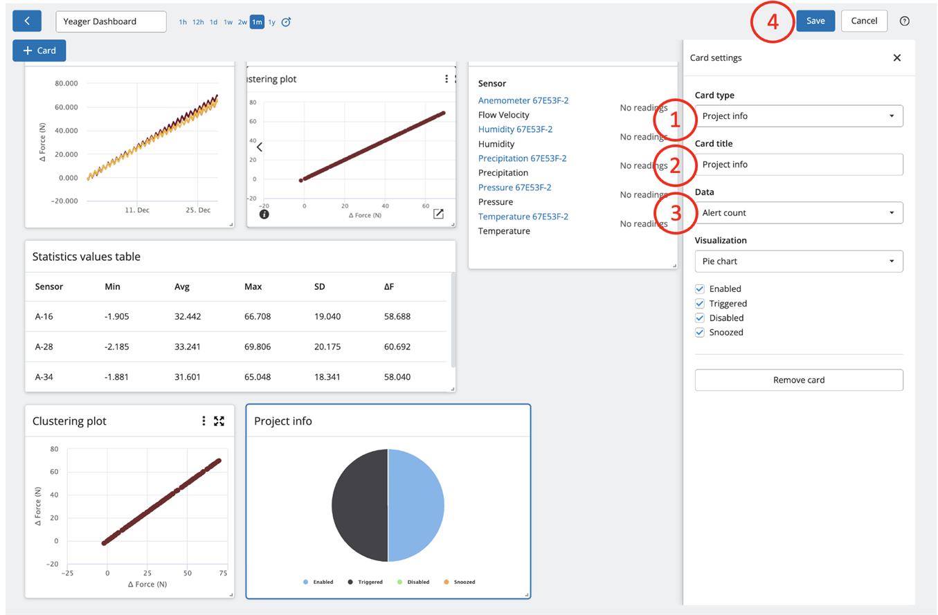

To create a new card, the user can click the    icon within the upper left corner of the screen to begin customizing a new card. Upon adding a new Card, a placeholder card will be added to the Dashboard, and along the right side of the screen the user will be given the first set of configuration options for the card, "Card Type" and "Card Title".
1. From the "Card Type" dropdown list, select "Project Info".
2. "Card Title" allows the user to name the card.

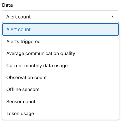

3. The "Data" selection dropdown is a list of available data that can be viewed within the Project Info card. Options are displayed in the image below.

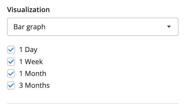

Additional configuration options, if applicable, will be dictated by the selection in the Data dropdown. Below is an example of the additional configuration options available for the Bar Graph. For any questions regarding additional configuration options, please reach out to the iTwin IoT Customer Success team here.
4. Once these selections and configurations are made, the placeholder card will be replaced by the "Project Info" card, as illustrated below. Click the blue "Save" button in the upper right to save the card to the Dashboard, or to immediately configure another card to the Dashboard click the "+Card" button on the upper left.

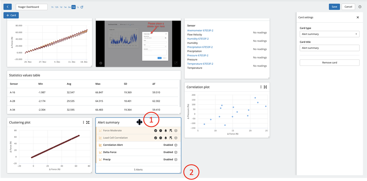

Manipulating the Card
After several cards have been created, a user may need to move or resize cards to best visualize data and information. Within Dashboard edit mode, the user can move or resize cards. After making any changes, be sure to save the changes by clicking the blue "Save" icon on the upper right corner of the Dashboard.
1. Moving Card- If hovering over the upper title portion of a card, a "Move" icon will appear. Click and holding allows the user to drag and drop the Card. Other cards will be repositioned automatically as the selected card is moved.
2. Resizing Card- Clicking the lower right corner of the card allows the user to change the vertical and horizontal size of the card.
