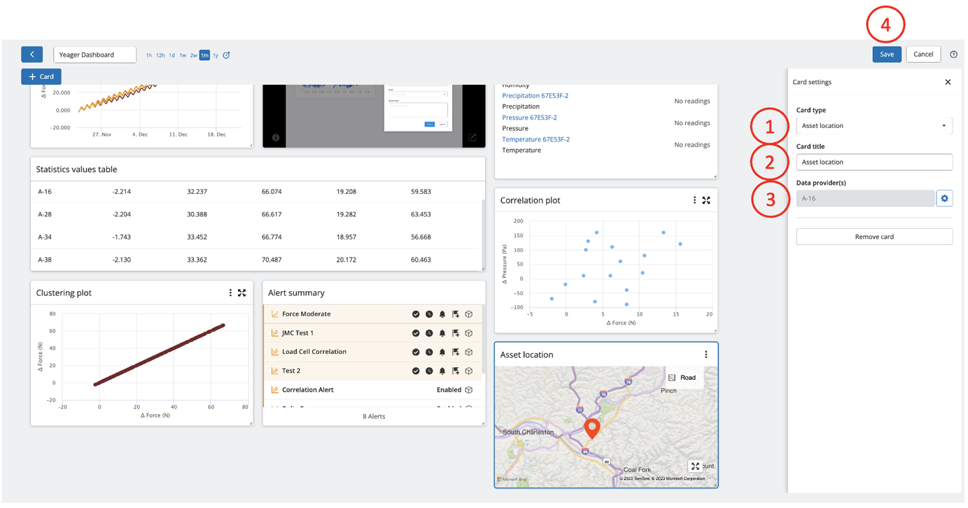

To create a new card, the user can click the    icon within the upper left corner of the screen to begin customizing a new card. Upon adding a new Card, a placeholder card will be added to the Dashboard, and along the right side of the screen the user will be given the first set of configuration options for the card, "Card Type" and "Card Title".
1. From the "Card Type" dropdown list, select "Sensor Events".
2. "Card Title" allows the user to name the card.

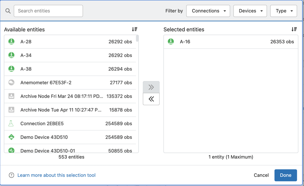

3. Click the blue gear icon to select the sensor. After clicking the icon, a pop-up selection window will appear, illustrated below. The user can select one sensor from the available sensors list. After making the sensor selection, click the "Done" icon in the lower right of the pop-up window.

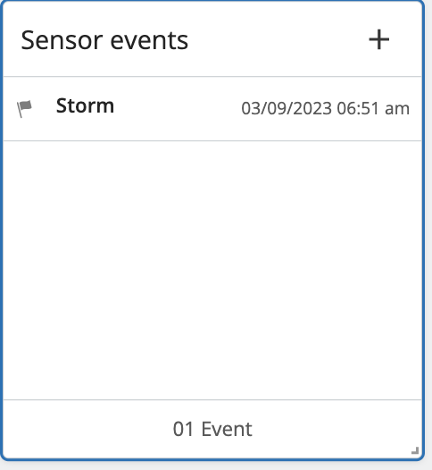

4. Once these selections are made, the placeholder card will be replaced by the "Sensor Events" card, as illustrated below. Click the blue "Save" button in the upper right to save the card to the Dashboard, or to immediately configure another card to the Dashboard click the "+Card" button on the upper left.

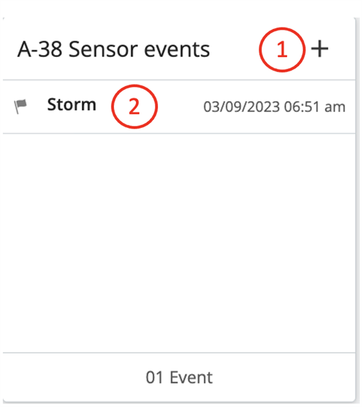

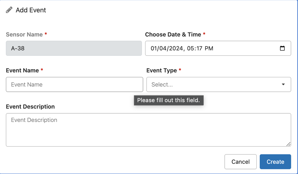

1. Create Event- The "+" icon allows the user to add a new event for the selected sensor. The configuration page for the new event is illustrated below.

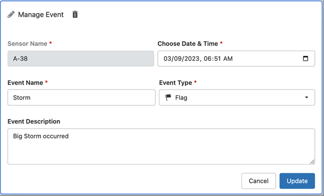

2. View/Edit Event- Clicking on the name of an event opens a page to view, edit, or delete the previously created event. The "Manage Event" page is illustrated below.
