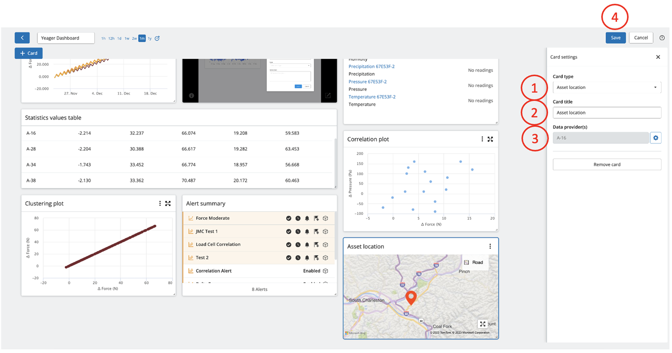

To create a new card, the user can click the    icon within the upper left corner of the screen to begin customizing a new card. Upon adding a new Card, a placeholder card will be added to the Dashboard, and along the right side of the screen the user will be given the first set of configuration options for the card, "Card Type" and "Card Title".
1. From the "Card Type" dropdown list, select "Sensor Summary".
2. "Card Title" allows the user to name the card.

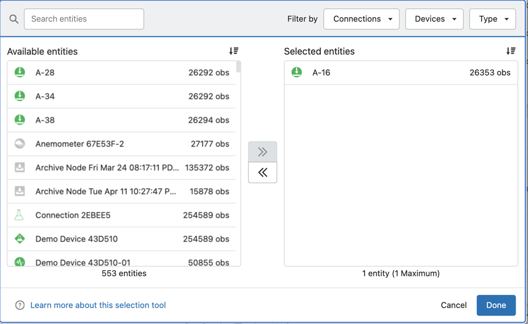

3. Click the blue gear icon to select the sensor. After clicking the icon, a pop-up selection window will appear, illustrated below. The user can select one sensor from the available sensors list. After making the sensor selection, click the "Done" icon in the lower right of the pop-up window.

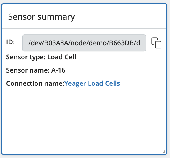

4. Once these selections are made, the placeholder card will be replaced by the "Sensor Summary" card, as illustrated below. Click the blue "Save" button in the upper right to save the card to the Dashboard, or to immediately configure another card to the Dashboard click the "+Card" button on the upper left.

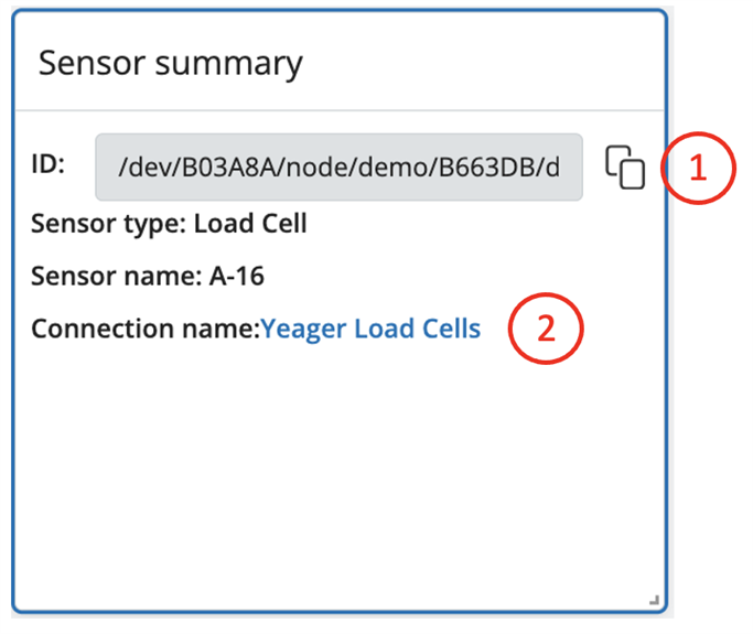

1. Copy Sensor ID- Allows the user to automatically copy the Sensor ID to the clipboard.
2. Connection Link- Link that will bring the user to the Connection Details page in the Connectivity Module for the Connection the selected Sensor is associated with.
