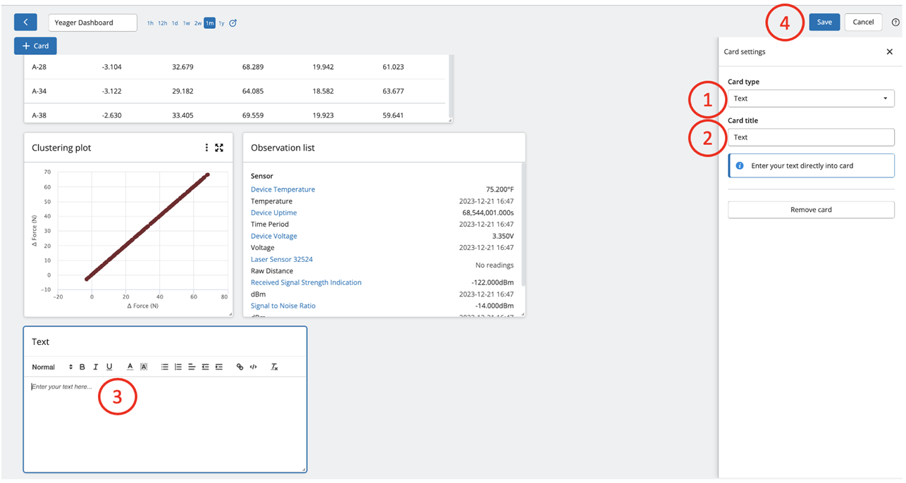

To create a new card, the user can click the    icon within the upper left corner of the screen to begin customizing a new card. Upon adding a new Card, a placeholder card will be added to the Dashboard, and along the right side of the screen the user will be given the first set of configuration options for the card, "Card Type" and "Card Title".
1. From the "Card Type" dropdown list, select "Text".
2. "Card Title" allows the user to name the card.
3. Text Input- The text can be input within the card. Text formatting options are available along the top of the card.
4. Click the blue "Save" button in the upper right to save the card to the Dashboard, or to immediately configure another card to the Dashboard click the "+Card" button on the upper left.
