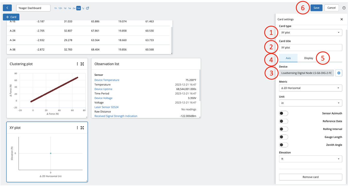

Creating a Dashboard Card
To create a new card, the user can click the "+Card"  icon within the upper left corner of the screen to begin customizing a new card. Upon adding a new Card, a placeholder card will be added to the Dashboard, and along the right side of the screen the user will be given the first set of configuration options for the card, "Card Type" and "Card Title".
1. From the "Card Type" dropdown list, select "Single XY Plot".
2. "Card Title" allows the user to name the card.

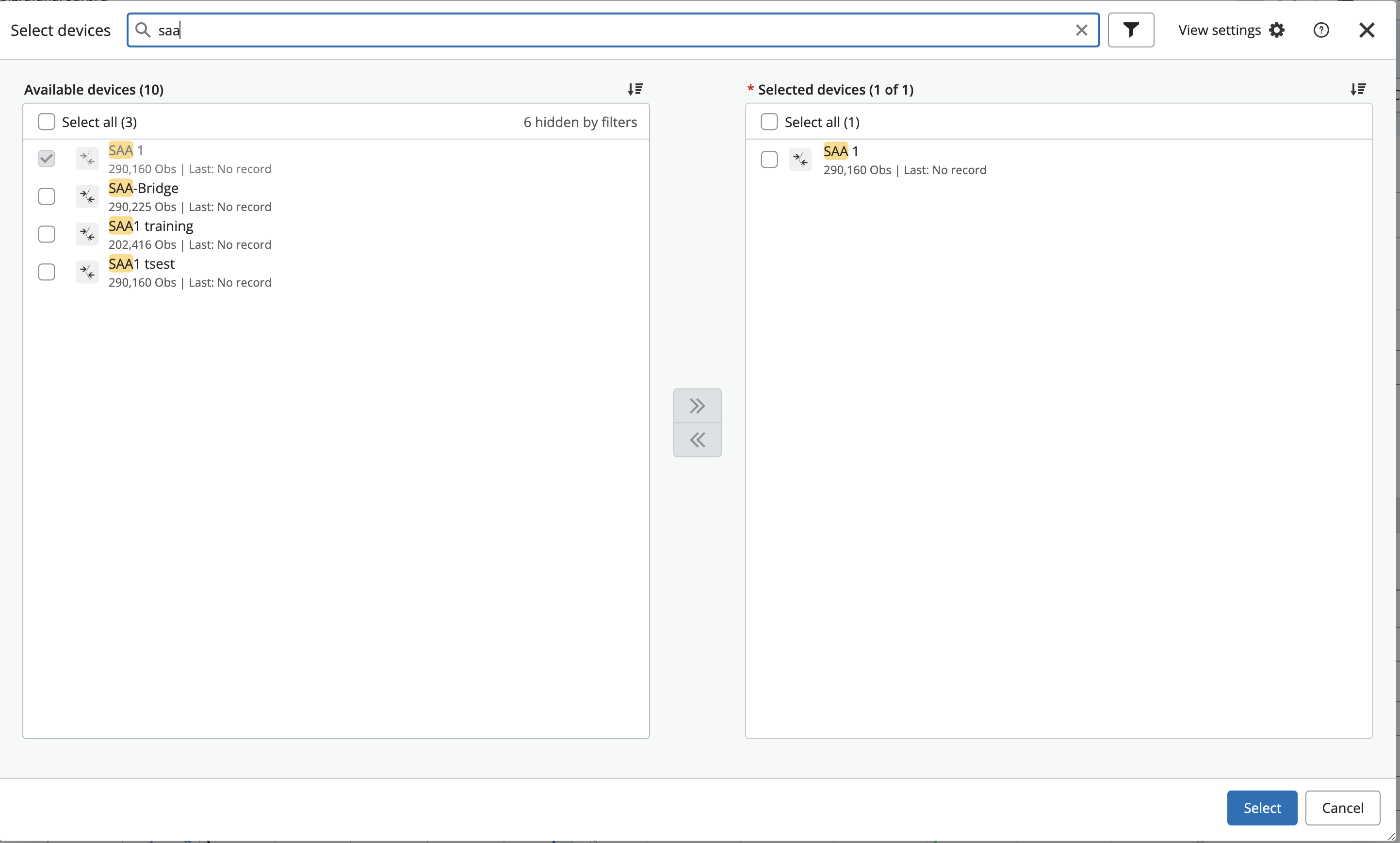

3. Sensor Selection- Click the blue gear icon to select the sensor. After clicking the icon, a pop-up selection window will appear, illustrated below. The user can select one sensor from the available sensors list. After making the sensor selection, click the "Done" icon in the lower right of the pop-up window.

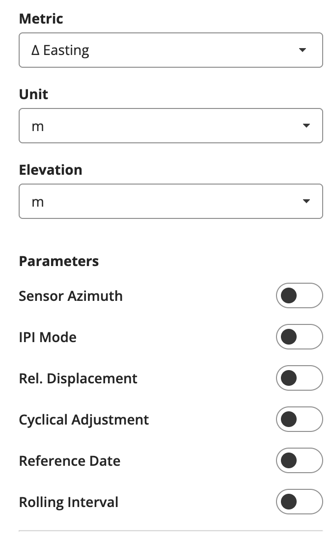

4. Axis Options- Once the sensor is selected, the XY card can be configured starting with the Axis.
The axis tab allows the user to control the following:
Metric: Configure the displayed metric on the X-axis (Y-axis for Shape Arrays configured horizontally).
Unit: Change the displayed metric's unit on the X-axis
Elevation:  Change units for the elevation axis (Y-axis if configured vertically).
Parameters: Change sensor configuration settings for the data output on the card. The configuration parameters are as follows:
Sensor Azimuth: This is to override the Sensor Azimuth correction set for the device. This only applies for select metrics that use the Azimuth adjustment.
IPI Mode: This is to override the devices reference/zero end, it can be far or near.
Rel. Displacement: Number of segments to look back when calculating displacement. Set to 1 for a traditional incremental displacement. If Cumulative Displacement is needed then setting this to OFF is needed, as it is by default.
Cyclical Adjustment: This is to override the Cyclical Adjustment parameter for your device. For further details on Cyclical Adjustment please read through this article on Measurand's Knowledge Base.
Reference Date: This is to select the reference date for all Δ Metrics such as ΔEasting and etc. This reference date will serve as the Baseline. If this is not set in the device nor in this parameter then the oldest reading in the XY graph will be used as the Reference Date.
Rolling Interval: This is used for all Δ calculations and to set a rolling window of reference instead of one fixed observation.

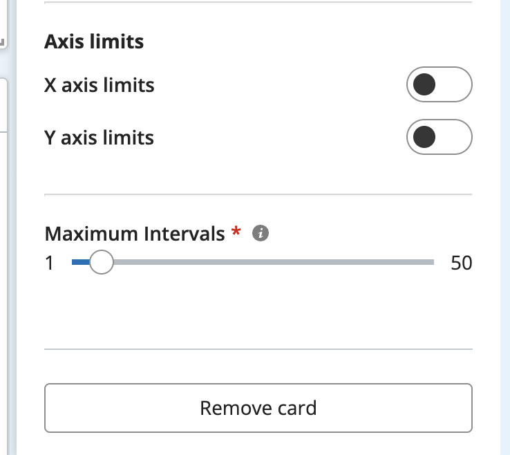

Axis Limits: This is to set the limits for your axis, by default the scale is automatic
Maximum Intervals: This is to set how many observation points you want to display on your graph, for example 10 observations for a 2 week window will show 10 evenly spread out observations for that 2 week window.

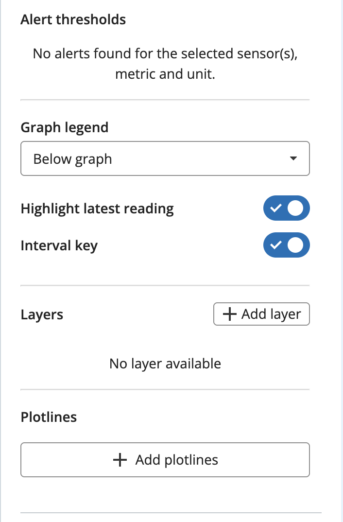

5. Display Options- The Display tab allows the user to control elements of the XY plot card.
Alert threshold: If any alerts are set up for the graphed sensor, alert thresholds can be toggled on/off to be displayed on the XY card.
Graph Legend:  Apply a graph legend for the XY plot. It can be at the top, bottom or floating for the graph.

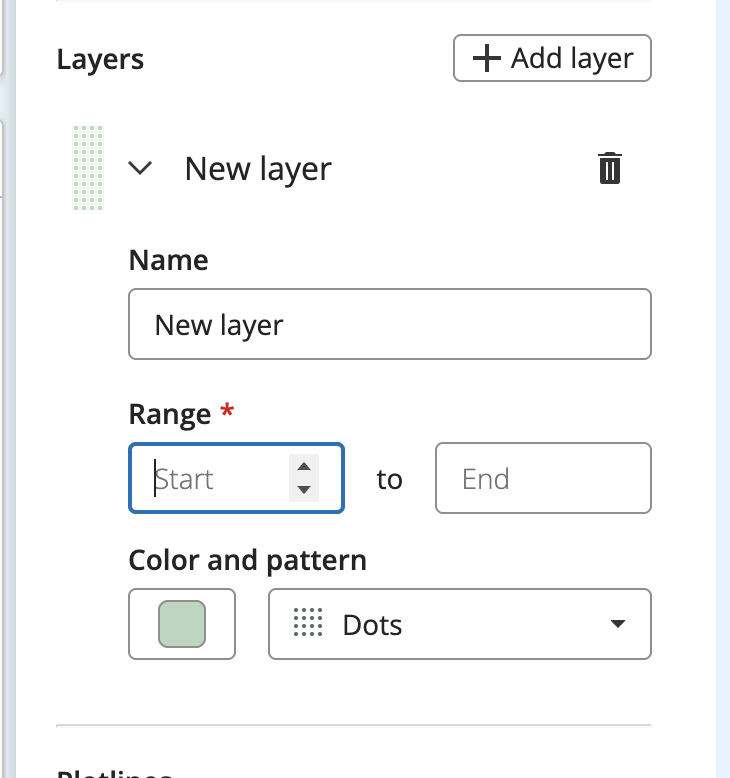

Layers: This allows you to define layers with labels on the Y-axis of the plot, effectively serving as a rudimentary stratigraphy graph.
Plotlines: This allows you to insert a fixed line in the XY plot either on the X-Axis (vertical) or on the Y-Axis(Horizontal)

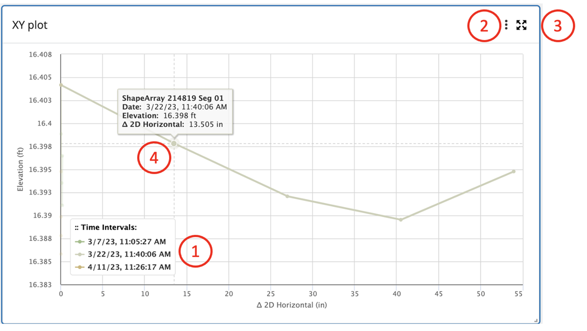

Clustering Plot Card Options
Once the card is configured, a number of additional options become available. This section will cover those options.
1. Legend- The legend in the lower left allows users to click the timer intervals to hide/show them on the clustering plot card.
2. Kebab Options- The kebab icon in the upper right opens a download options tab with several download format options.
3. Full-screen mode- Opens the graph in full-screen mode within the current browser window.
4. Hover- Hovering over a point allows the user to see specific details about that reading.

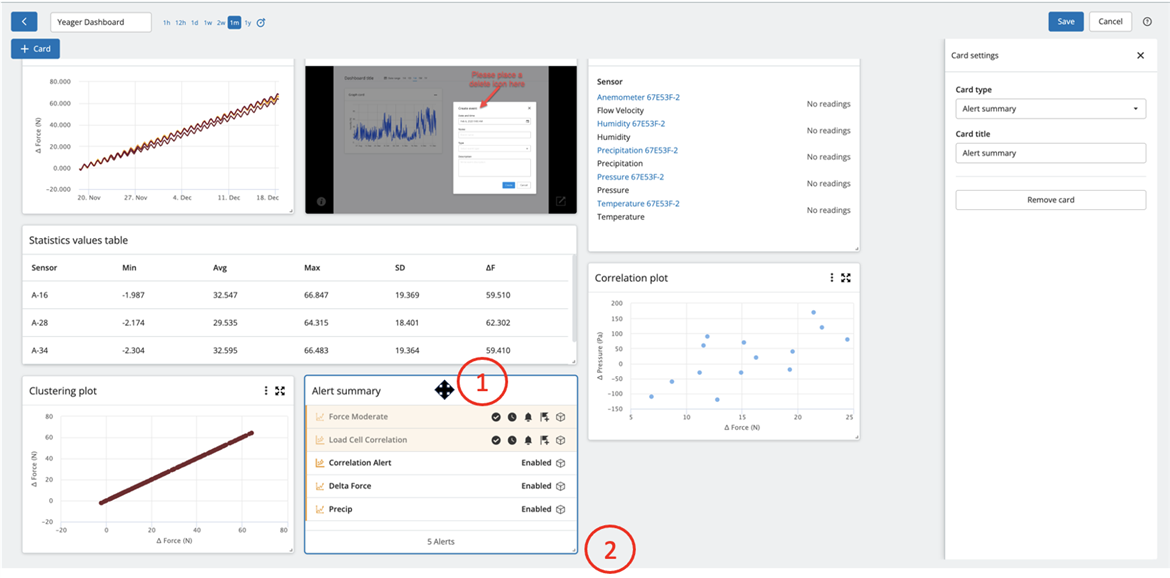

Manipulating the Card
After several cards have been created, a user may need to move or resize cards to best visualize data and information. Within Dashboard edit mode, the user can move or resize cards. After making any changes, be sure to save the changes by clicking the blue "Save" icon on the upper right corner of the Dashboard.
1. Moving Card- If hovering over the upper title portion of a card, a "Move" icon will appear. Click and holding allows the user to drag and drop the Card. Other cards will be repositioned automatically as the selected card is moved.
2. Resizing Card- Clicking the lower right corner of the card allows the user to change the vertical and horizontal size of the card.
