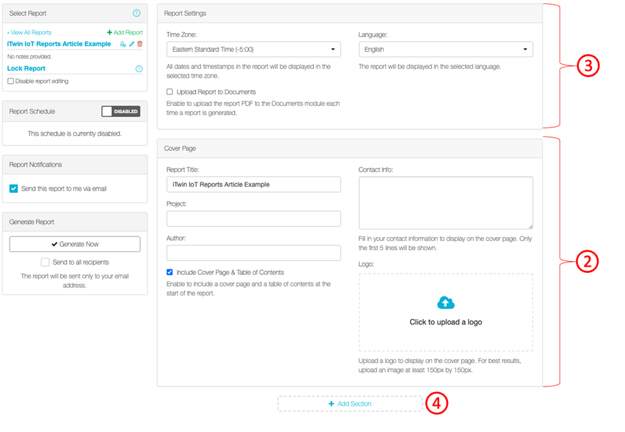

2. When creating a new report profile the first section shown will be the cover page. this will be the first page in your generated report. In this page you can enter the report title, project, author, author's contact info, and company logo.
3. Next, you can select the preferred timezone that the report will use. This will ensure your graphing profiles in the report are shown in the correct time zone.
4. Click the add section button to begin adding additional sections to your profile. Your additional section options are as follows:

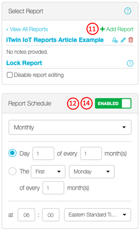

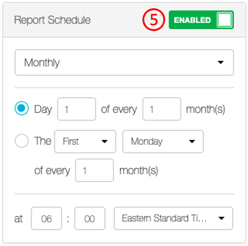

5. Once you are satisfied with the content of your report, you can schedule automated delivery of your report by enabling the Report Scheduler. You will be able to schedule Daily, Weekly, and Monthly reports - with customized parameters for delivery of each within that period.

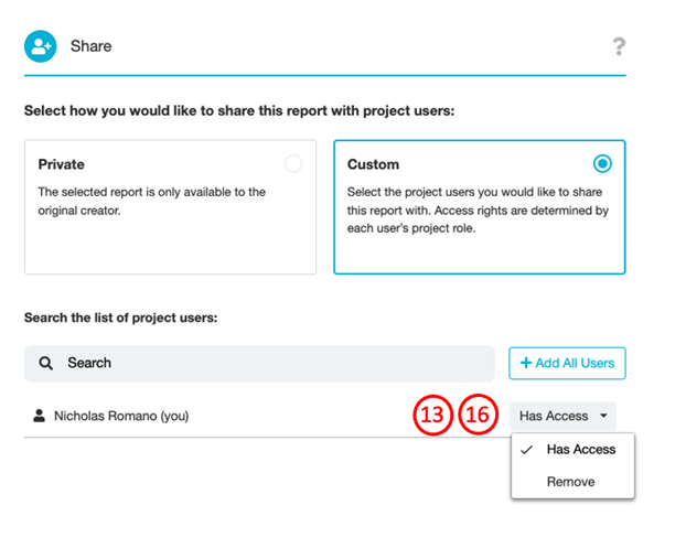

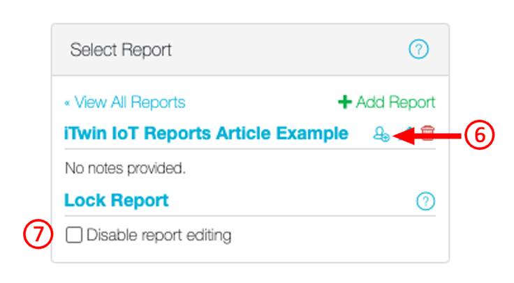

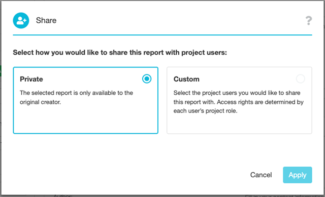

6. Reports can be shared by selecting  this will give you the option to select private, sharing to only yourself, or to select custom which will allow you to choose the users that you would like to receive the report.
Note: At this time you can not add email receipts that are not registered on the iTwin IoT app.
7. Selecting Disabling Report Editing will disable any users ability to edit the report profile. With Disable Report Editing enabled any changes made to the report profile will revert when navigating away from the report profile or refreshing the page.

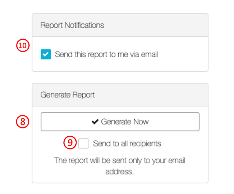

8. When you are finished creating your report profile you can select   to create an example of what your report will look like.
9. Checking the box next to  will send your sample report to all users that you have shared your report profile with.
10. Checking  will send a copy of the report to your email. If this box is not checked the report will only generate in the documents module under reports.

11. Delete the report entirely by clicking the
12. Edit the report to send less frequently or disable the report from being sent at all.
13. Change the viewing permissions of everyone on the report, including yourself.

14. Edit the report to send less frequently or disable the report from being sent at all.

16. View the report and only change your permission to "Remove"
