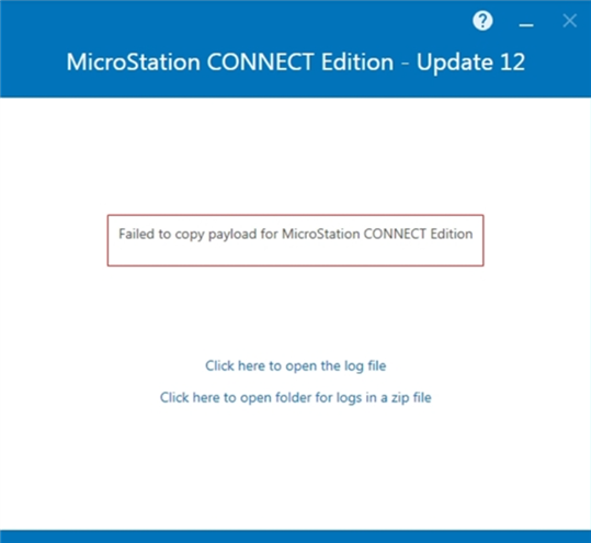

During the installation of MicroStation, the message "Failed to copy payload” error appears and the installation cannot be completed.

The Pay load errors are often download related. Perhaps some components were not downloaded correctly.
Try to remove MicroStation by using the Windows Troubleshooter
 Next, create a Deployment image to download and install all MicroStation components:
MicroStation CONNECT - How to create a Deployment Image
 Remember to run the file microstation.exe as administrator.

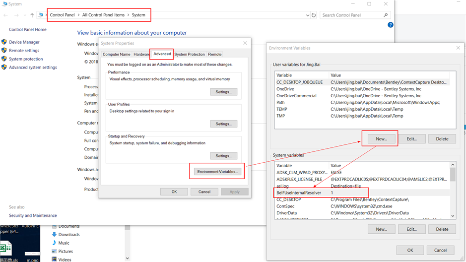

Option 3
Create a new Windows system environment variable BeIFUseInternalResolver and set its value to 1.
BeIFUseInternalResolver = 1
Open the System> Advanced system settings> System Properties dialog from the Control Panel.
Create a new variable from the Advanced tab> Environment Variables> New button.
After creating the system environment variable, reattempt the MicroStation installation.
