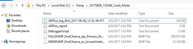

     After reproducing the crash successfully, allow some time for the memory dump to complete, the command prompt highlighted above will disappear. Once this has been completed please zip up the folder “20170606_135346_Crash_Mode” with the crash dump and upload the zip files to sharefile location provided in the email.
     Below is an example of a folder with a crash dump inside:
     C:\Temp\20170606_135346_Crash_Mode\
Note: The log file generation takes a long time. Do not close the following window marked with Red box.
