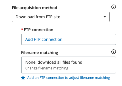

Download from FTP site

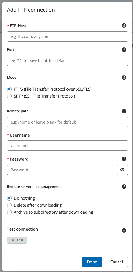

FTP Connection
When configuring your file import to fetch data from an FTP server of your choosing the first step is to configure the FTP connection itself. You can do that by clicking the Add FTP Connection option.
This will open up a window that allows you to configure and test your FTP connection for this File Import profile.
The settings are as follows:
FTP Host: This is the URL or IP address of your FTP server. For example: ftp.company.com or just data.company.com
Port: This is the FTP port, by default it is 21 but you can change this if your server uses an alternative port.
Mode: This enables you to choose FTPS or SFTP.
Remote Path: This is the remote path for accessing the files. If your user points at the root then you can set a default sub-path here, for example /UK/IPI/ or /NL/IPI/ . If you are unsure then leave this empty.
Username and Password: This is the username and password for your FTP user. Take care that this user has to have view, edit and create privileges on your FTP server so that the iTwin IoT FTP download function works properly.
Remote server file management:
Under this settings there are three options.
Do nothing: This means that once iTwin IoT fetches the datafile and imports the data from it it leaves it alone, this is useful if you just have one datafile that your datalogger appends data to.
Delete after downloading: This means that once iTwin IoT fetches the datafile and imports the data from it it deletes the file. This can be useful if you have a fast datastream with many files and you want to clean up your server as you import data into iTwin IoT.
Archive to subdirectory after downloading: This means that once iTwin IoT fetches the datafile and imports the data from it it moves that file into an archive sub-directory within the directory where that datafile is located. This is mostly useful when using incremental file import, that is one file contains one or a couple of datalines and the datalogger creates a new file for each measurement.

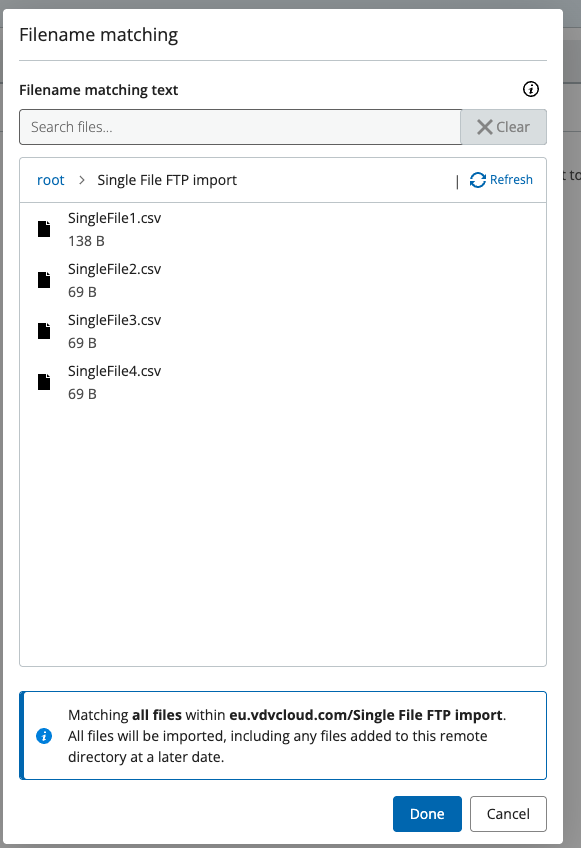

Filename matching
Sometimes your folder with your datafile has multiple files from other dataloggers that you do not want to import.
Filename matching allows you to define a matching criteria to your Filename and to ignore files that don't match that pattern.

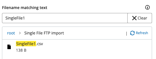

Here the folder contains 4 files from 4 different loggers but the import should only pick up SingleFile1.csv. In this case adding a SingleFile1 matching text will only match it with any file with that name in it.
As you are typing in the matching text the display of files will change according to your filtering name. Once you are done you click Done and now that Filename pattern will be stored for this File Import profile.

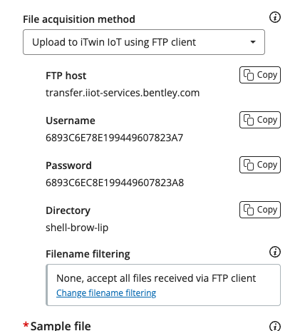

Accessing FTP Information
Once you have created a file import as shown in the Creating and Configuring a File Import article you will be able to upload data automatically to the FTP folder that was created for that File Import. In the image below you can see the FTP host/server URL, the username, password and directory for this particular File Import Profile. This is the FTP information used for sending data via FTP to your File Import profile.

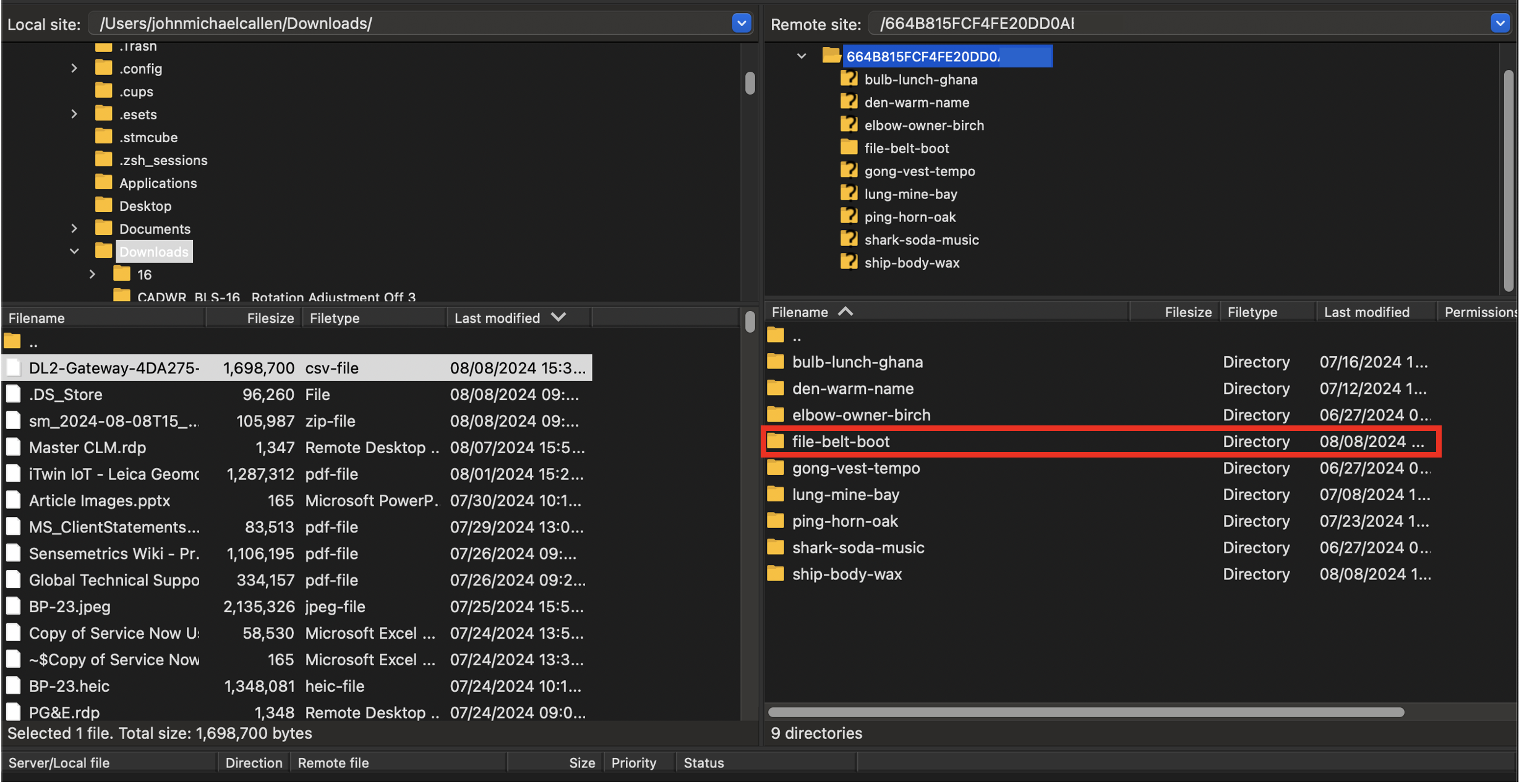

Filezilla FTP setup (Workflow 1)
1. Host, Username, Password Inputs- The FTP credential inputs will be at the top of the page. Input the data collected from iTwin IoT above into the corresponding inputs labelled alphabetically. A, b, and c will only be used in this initial configuration step. You can match the host (a), username (b), and password (c) with the information collected above. A port number does not need to be input.
An example of this information entered into the QuickConnect bar of Filezilla is displayed below.
Once the FTP is configured, click the "Quickconnect" button. A status message should appear at the top saying the connection is successful, and you will see a list of directories appear on the right hand, Remote site", side of the Filezilla page. Proceed to the next section if the connection succeeds.
 If the connection fails, check the input information from above and ensure there are no firewall settings on your network or computer that prohibit FTP usage. This information can be found at the top of the page or in this support article. If you've checked all of these possible issues, please contact our support team for assistance.

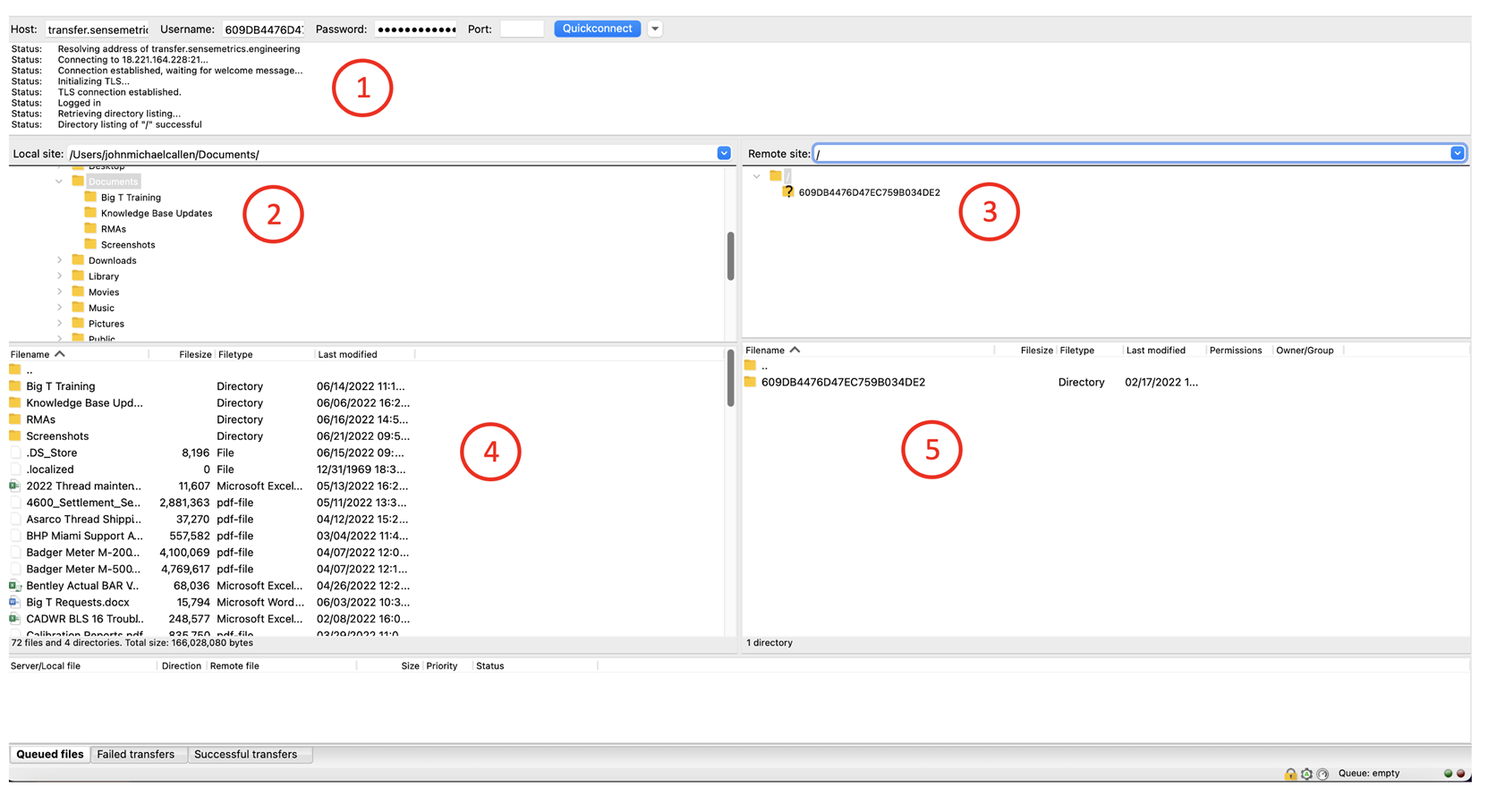

 FTP Connection and File Transfer
After clicking the "Quickconnect" button, Filezilla will then attempt to connect between the iTwin IoT remote host and the user's computer.
1. Status Bar- The Status Bar provides a log of operations for the FTP. If the connection procedure above was followed correctly, the Status notes bar will end with the note "Status: Directory listing of "/" successful". Sections 2, 3, 4, and 5 will populate once the connection is successful.
2. Local Host Folders- The user's computer drives and folders will be displayed on the upper-left window. Navigating through drives and folders within this window will change the sub-folders and files displayed in the lower-left window.
3. Remote Host Folders- The iTwin IoT file directory for the FTP documents module will be displayed in the upper-right corner. The selected file should be the file with the Username displayed as the folder name, typically an alphanumeric string. Clicking on this username will display the sub-folders within, also called the directories, which are the randomly generated folder names from the Import profile creation step earlier. Note: The username and password will be shared for all Import Profiles created within a given project. All Import Profiles created within an iTwin IoT project will be visible as a folder under the username in this window.
4. Local Host Sub-Folders and Files- The user's computer sub-folders and files, as selected in window 2, will be displayed on the lower-left window. Folders and files from this window can be dragged and dropped to the right into the Remote Host folders, but a Directory must be created first in Step 5. When dragging and dropping, confirm that a green "+" box appears on the Remote Host Directory folder you are transferring the file into to ensure success.
5. Remote Host Sub-Folders and Files- Sub-folders, or directories, are automatically generated when creating an Import Profile in iTwin IoT. To ensure that data is going into the correct directory for the File Import profile, please reference the Automation tab in iTwin IoT. The image below highlights the location of the auto-generated directory name. Note: All Import Profiles created within an iTwin IoT project will be visible as a folder under the username in this window.
Files can be uploaded into the directory to make them visible in the Import Profile by drag and drop or by highlighting the directory and file/files then clicking upload. When dragging and dropping, confirm that a green "+" box appears on the Local Host folder you are transferring the file into to ensure success. The screenshot below is a highlighted example screenshot illustrating where the directory is located in Filezilla.

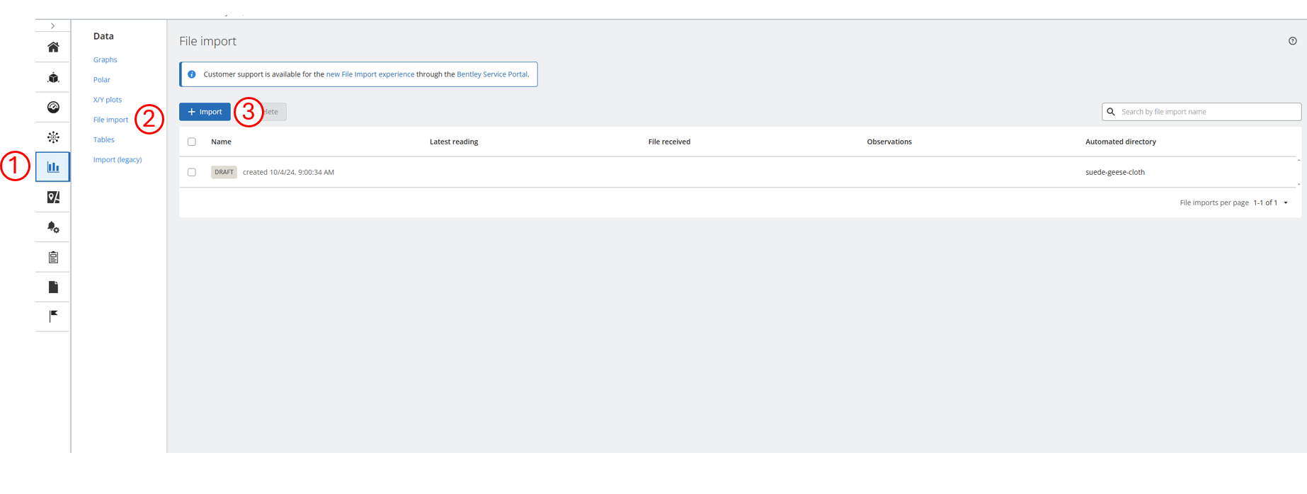

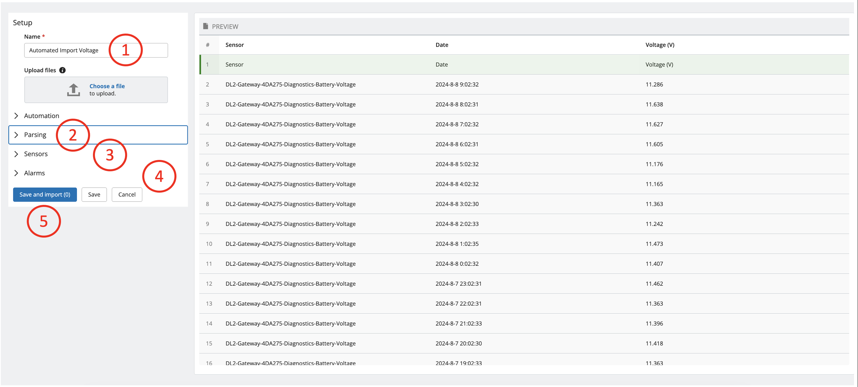

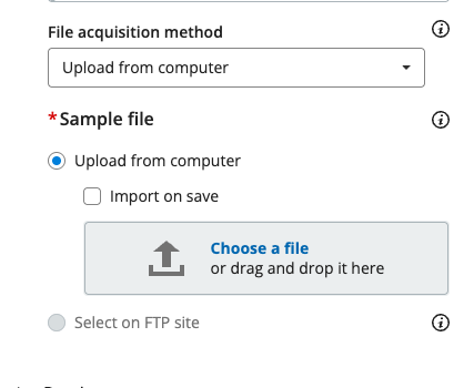

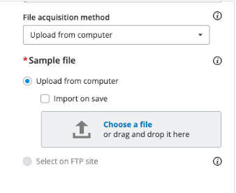

Manual File Import
This method is mainly useful for uploading manual measurements into the system. The first step is the same as with the automatic import but instead of having a datalogger or process send the data automatically to an FTP location you can either upload the data manually via iTwin IoT or send the data manually via FTP using Filezilla or comparable program, as is shown in this chapter of this article.

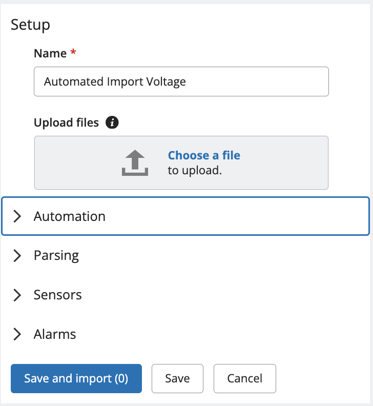

You start with configuring the import as shown in the Creating and Configuring a File Import article.
When creating your import and select the "Upload from computer" option. Then you upload your file.
If you want to add a manual measurement you navigate to the File Import profile and click "edit import"
Then you upload your new readings and click "Save and Import"
