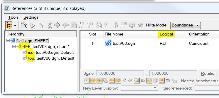

I would like to know the commands to turn off (and on) a particular level in a particular reference file on a sheet model; e.g. Reference file name "TestV08.dgn". I want to turn off the "Preliminary" level in that reference file on all sheets.
Logical name of reference at Sheet model as REF and the logical names of the sheet attachments as ISO and TOP
Command line for Batch Process:
LEVEL SET DISPLAY OFF file:"testV08.dgn" Preliminary;SELVIEW ALL;FILEDESIGN
REFERENCE LEVELS OFF PRELIMINARY REF->ISO;SELVIEW ALL;FILEDESIGN
REFERENCE LEVELS OFF PRELIMINARY REF->TOP;SELVIEW ALL;FILEDESIGN
