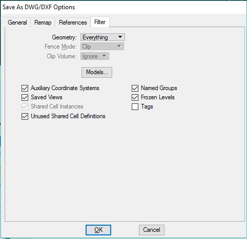

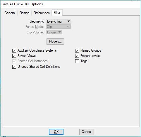

Figure 7:Filter Tab of the Save As DWG/DXF Options dialog.
FILTER TAB
Contains controls that are used to filter the data that is saved to the output file.
Geometry
Fence Mode
Sets the Fence Mode that, in conjunction with the fence placement, defines the fence contents for manipulation.
Clip Volume
Specifies whether a clip volume is used to filter the elements to be saved.
If set to Ignore (the default), clip volumes are ignored.
If set to a view, only the elements within the view's clip volume are saved. The clip volume is defined according to the Fence Mode setting (Inside, Overlap, or Clip).
Models
Opens the Select Models dialog box, which lets you choose the models to save to the output file(s).
Auxiliary Coordinate Systems
If on, saved Auxiliary Coordinate Systems are saved to the output file.
Saved Views
If on, saved views are saved to the output file.
Shared Cell Instances
If on, shared cell instances are saved to the output file. If off, all shared cell instances are converted to normal cells in the output file.
Unused Shared Cell Definitions
If on, all shared cell definitions are saved to the output file. If off, unused shared cell definitions are omitted from the output file.
Named Groups
If on, named groups are saved to the output file. If off, named groups are omitted from the output file.
Frozen Levels
If on, the geometry on frozen levels is saved to the output file. If off, geometry on frozen levels is omitted from the output file.
Tags
If on, tag elements are saved to the output file. If off, tag elements are converted to simple text elements in the output file.
