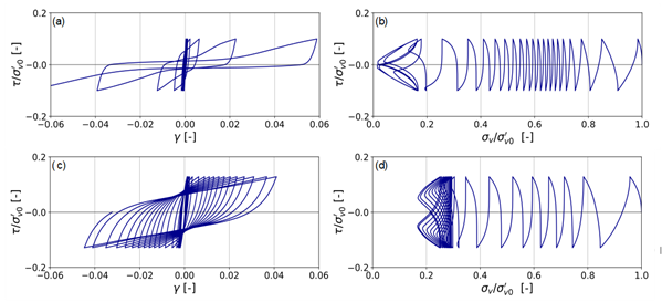

PM4Silt - PLAXIS UDSM results in CDDS test
Results from simulations of undrained cyclic DSS tests performed with two calibrations proposed for normally consolidated clayey silt and silty clay
