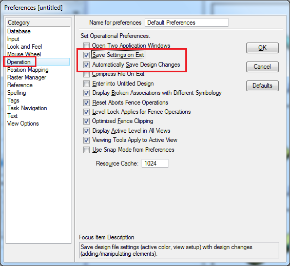

How to save design file changes automatically?
How to save settings automatically?
To Enable these in Preferences:
In V8i (Select Series):
1. Go to Workspace > Preferences.
2. Go to the Operation section.
3. Toggle on Save Settings on Exit
4. Toggle on Automatically Save Design Changes

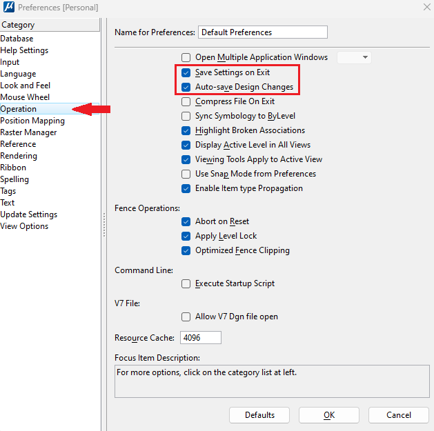

In CONNECT / 2023 - 2025:
1. Go to File > Settings > User > Preferences
2. Go to the Operation category
4. Toggle on Auto-save Design Changes
Note: In instances where working on files across a network drive, it might be advisable to turn off the "Auto-save Design Changes"
