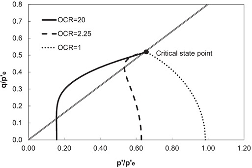

Compared with normally consolidated clays, over-consolidated clays are characterized by a lower void ratio, a higher strength stress and exhibit a stress dilatancy in combination with strain softening failure during the postpeak regime (Yao et al., 2008 ).
To fill this gap, several formulations have been proposed in the past to better capture the salient features of an OCC deposit (Pender, 1978; Hueckel et al., 1992; Whittle, 1993; Mita et al., 2004; Yao et al. 2009; Gao et al., 2017; Chen and Yang, 2017; Sternik, 2017). Recently, a model using a state parameter as a fundamental variable to characterize the consolidation process of a clay has been implemented by Jockovic and Vukicevic (2017) to mimic the behavior of OCC, thus showing the applicability of this approach for this class of materials. Specifically, the framework of critical state mechanics has been combined within a bounding surface approach through the definition of a state parameter.
The PLAXIS implementation of the HArdening State Parameter (HASP) model (Jockovic and Vukicevic, 2017) is presented to show the capability of these constitutive equations in simulating laboratory experiments on OCCs. To improve the model performance, the Small-Strain Overlay model (Benz, 2007) is integrated in the HASP framework to better capture the non-linear degradation of the shear properties which are crucial to evaluate the deformability of geotechnical structures. After the material calibration, some practical problems solved with the HASP model and PLAXIS 2D/3D code are also presented.
