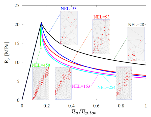

This Hoek & Brown model implemented in PLAXIS refers to the formulation proposed by Jiang (2017) which can guarantee at the same time smoothness and convexity of the yield surface and plastic potential. The underlying implementation is further enhanced with the following constitutive features:
