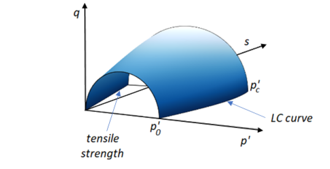

The Barcelona Basic model (BBM) is a Cam-Clay type effective stress model for the behaviour of unsaturated clay-type soils. In contrast to the original BBM, the PLAXIS BBM is defined in terms of Bishop effective stress, suction as stress variables and Lode's angle dependency. A specific feature of the model is that it includes 'collapse' upon wetting.
