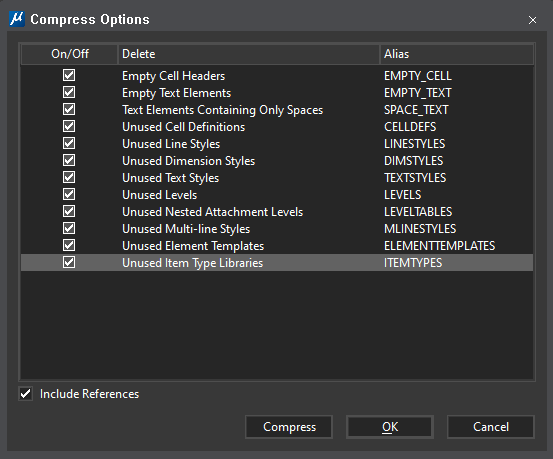

It takes too long time (approx. 1 hour) to drop a shared cells to geometry. File specific problem.
Compress file (all options activated), then drop shared cell.
This reduces time to drop the shared cell dramatically.
