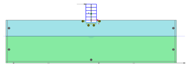

This example demonstrates the natural frequency of a five-storey building when subjected to free vibration and earthquake loading.
The building consists of 5 floors and a basement. It is 10 m wide and 17 m high including the basement. The total height from the ground level is 5 x 3 m = 15 m and the basement is 2 m deep. A value of 5 kN/m2 is taken as the weight of the floors and the walls. The building is constructed on a clay layer of 15 m depth underlayed by a deep sand layer. In the model, 25 m of the sand layer will be considered.
PLAXIS 2D Tutorial: Earthquake and building
