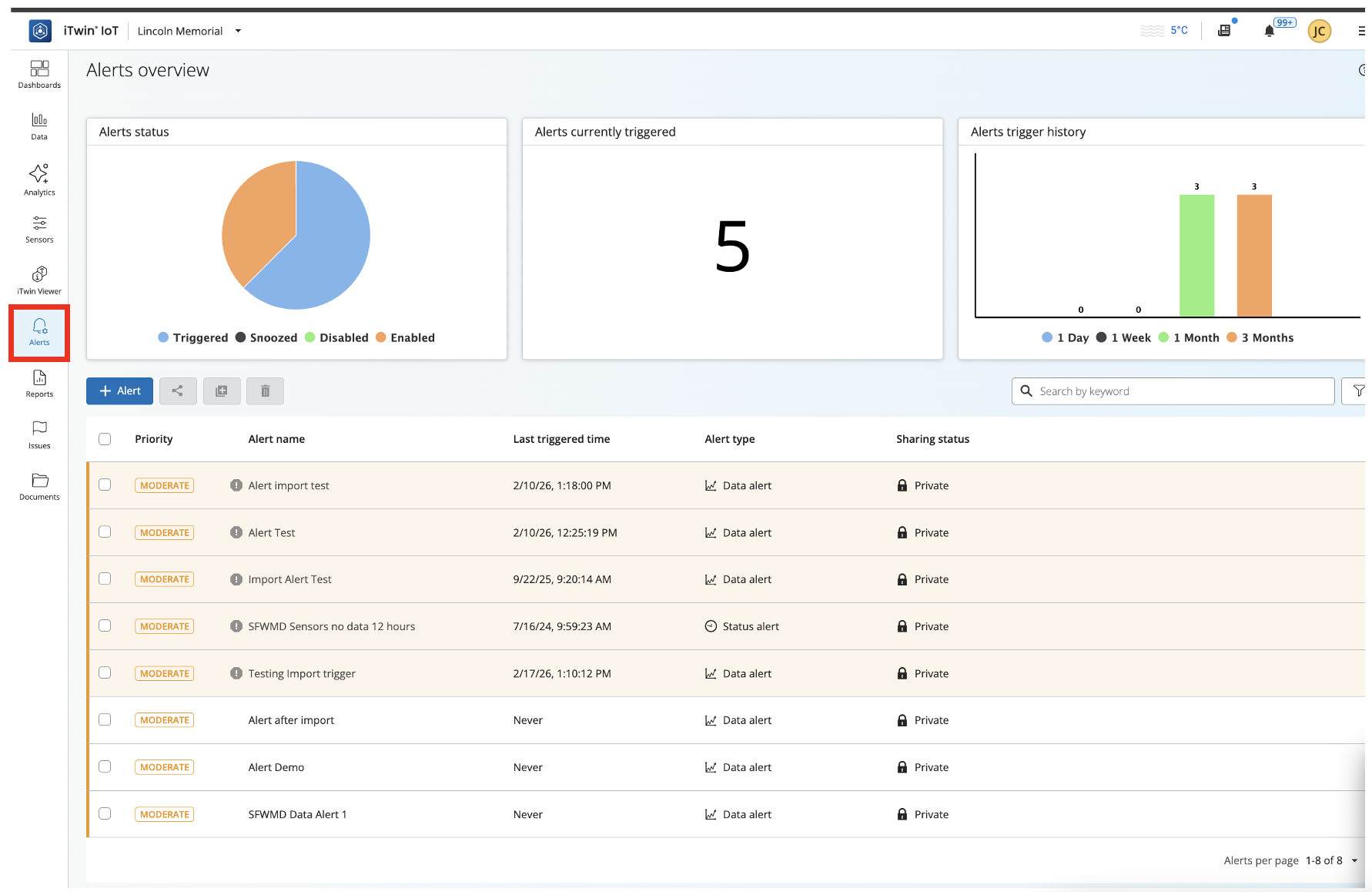

Alerts are designed to notify users of device and sensor statuses and update the user with critical sensor data via real-time notifications and emails. The user can also select actions that perform different functions if an alert is triggered. To navigate to the Alerts module, click on the "Alerts" icon on the left side navigation bar (outlined by red box). The user will be directed to the Alert Dashboard page below, which provides the user with a quick visual status indication of the alerts set up by or shared with the user.

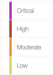

Alert Priority
When configuring a new alert or editing an existing alert, the user can select the color-coded criticality of the alert. The user can sort by Alert Priority on the Alerts page, and the Alert will be highlighted with its alert priority color upon triggering. Below is a chart with the color scheme assigned to each priority level.

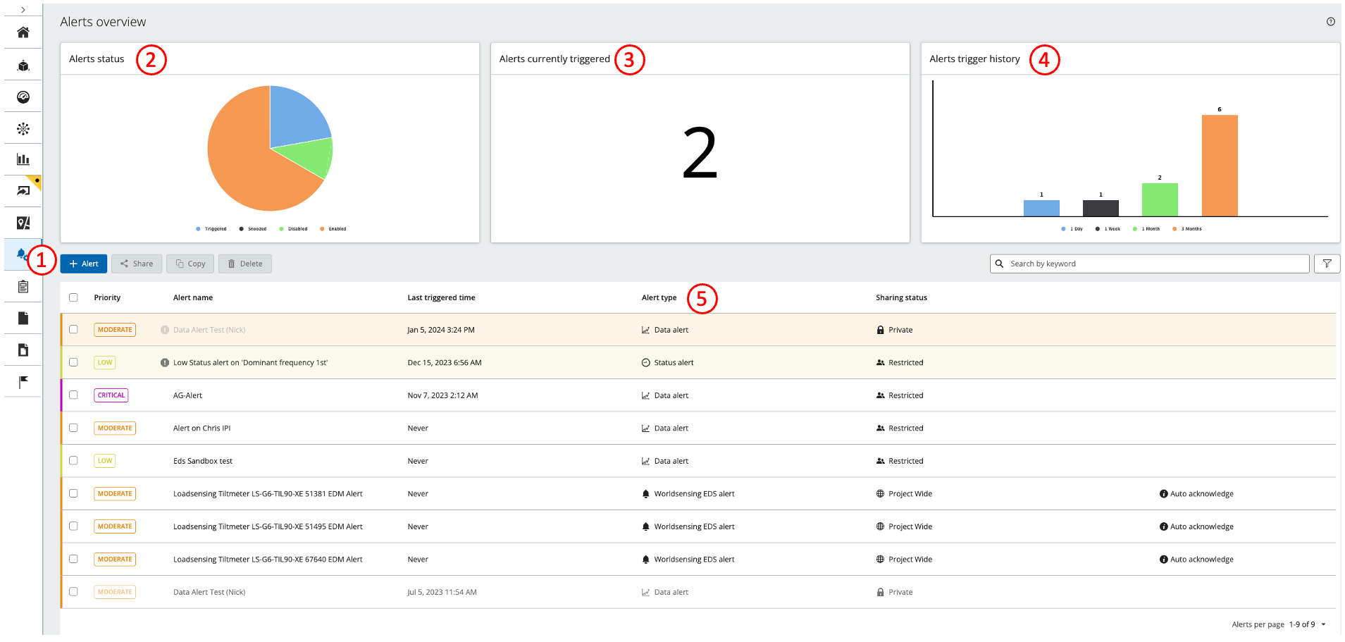

Alert Dashboard Overview
Now that the Alert basics have been reviewed, this section of the article will provide an overview of the Alerts Dashboard, the overview page of the Alerts Module.

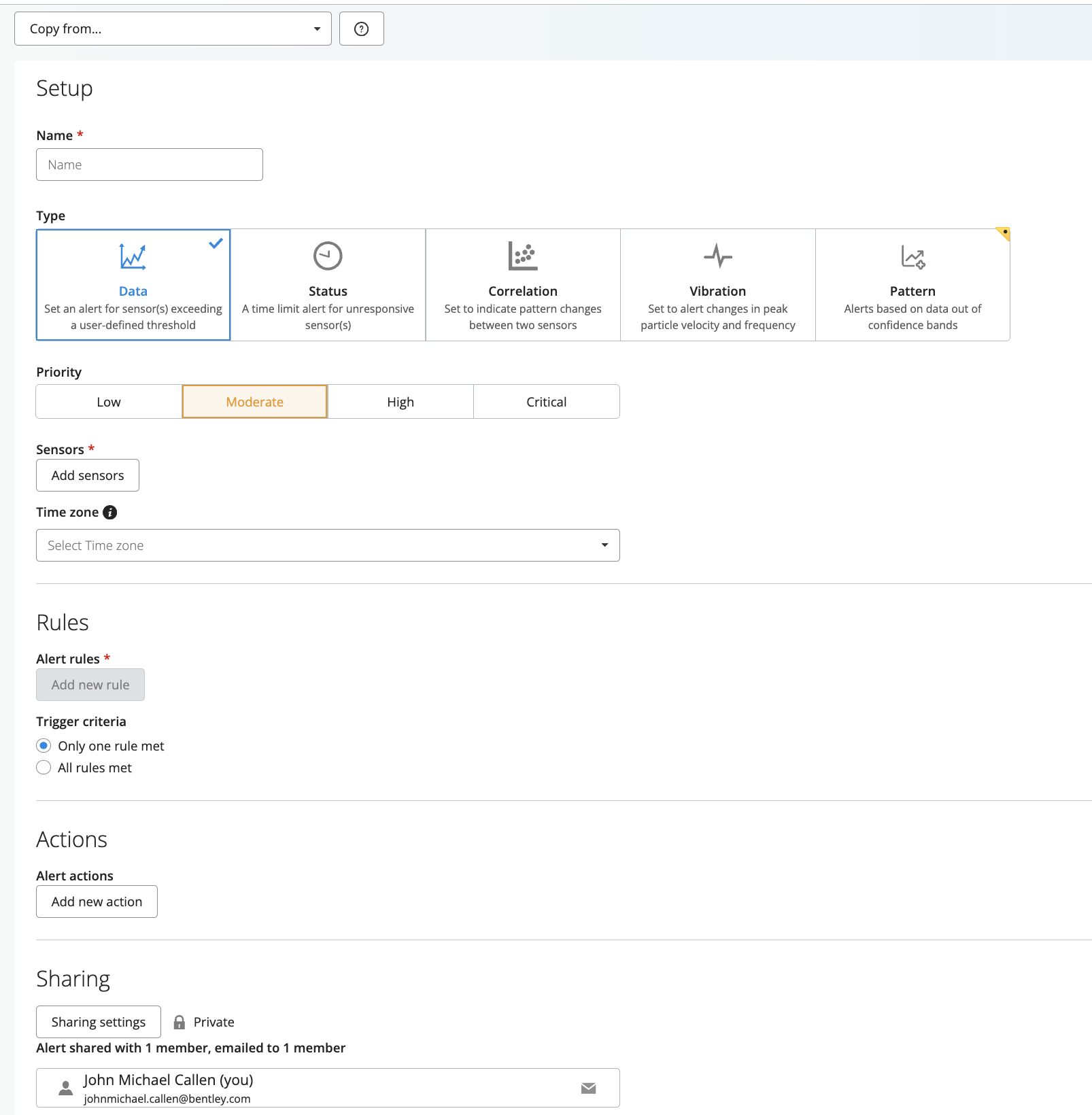

1. Create Alert
The    button will take the user to the new alert configuration page, illustrated below. For more information about configuring each alert type and their function, visit the respective Correlation, Data, Status, Pattern Alert article.
2. Alerts Status Pie Graph
This Pie Graph visually illustrates the Alert Status categorization breakdown of all alerts on the asset. Selecting a status from the legend or chart will remove that status type from the graph.
3. Alerts Currently Triggered Counter
The Alerts Currently Triggered window provides an "at-a-glance" ticker for the number of currently triggered alerts for the asset.
4. Alerts Trigger History Bar Graph
The Bar Graph gives the user a quick diagnostic regarding when alerts were triggered. Selecting a time frame from the legend or chart will remove that time window from the graph.
5. Alert Summary Window
The Alert Summary window provides a list of alerts created by or shared with the user. There is also some additional functionality within the summary window that will be explained below.
Alert status can be determined at a glance by the color and behavior of the alert in the summary window. Blinking alerts are currently triggered and are colored by their priority setting, enabled alerts have black text in the window, and disabled alerts have grey text. Each alert will show the criticality, date last triggered, type of alert, sharing status, and whether Auto Acknowledge is on or off within columns of the window.

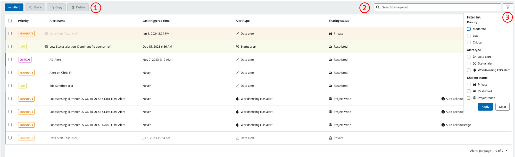

1. Selecting the box on the left side of any Alert will allow you to share, copy, or delete the selected alert/s.
2. Search alerts by a keyword.
3. The filter option allows you to filter by priority, Alert type, or Sharing status.

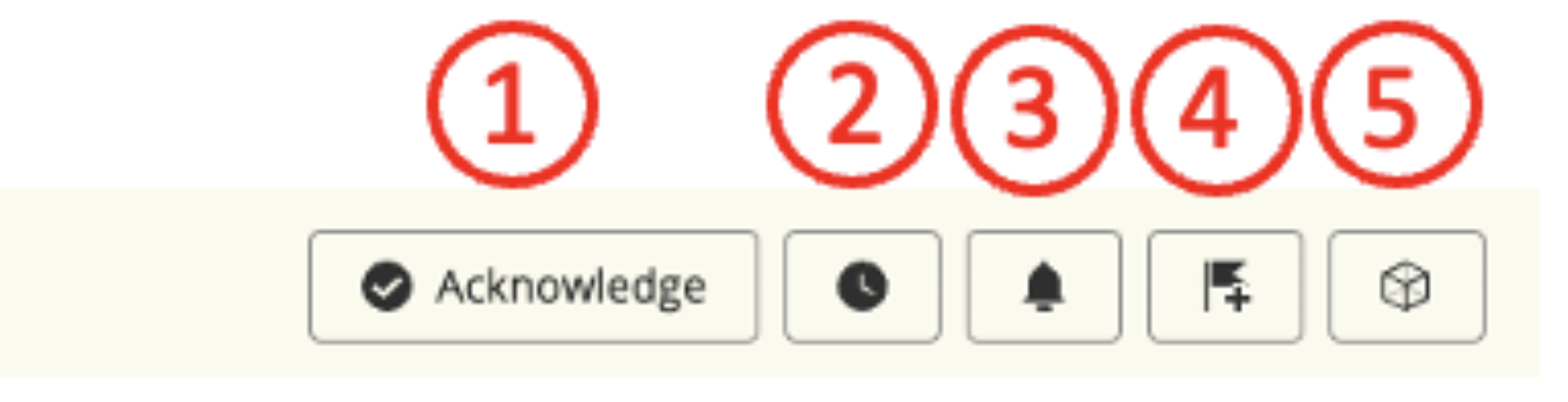

When hovering your curser over a triggered alert additional options will appear in the right side of the alert.
1. The  button will allow you to Acknowledge the alert.
2. TheIcon will allow you to snooze the alert, causing the alert to re-trigger at a later date. Currently 1 hour later is the default.
3. The  Icon will disable your alert.
4. The Icon will take you to the Issue Resolution module, where you can create an issue based on the alert you've selected.
5. The Icon will allow you to view this alert in your saved digital twin view.
Alerts that are not currently triggered will give you the option to disable, or view the alert in the Digital Twin module.
