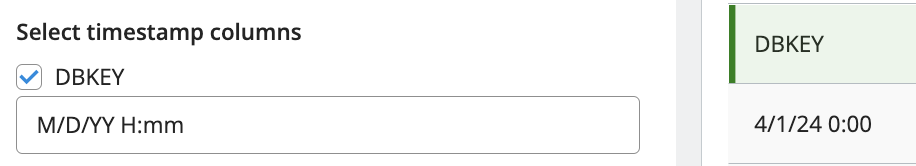

This section will cover some Time Format examples to aid the user in matching data formatting with timestamp configuration requirements in the File Import module.

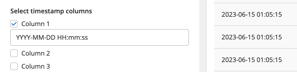

This is a theoretical example of formatting match:
Data File Timestamp: 2021-06-01 22:38:00
iTwin IoT Timestamp token configuration: YYYY-MM-DD HH:mm:ss
Below are some examples of formatting matches in the module:
