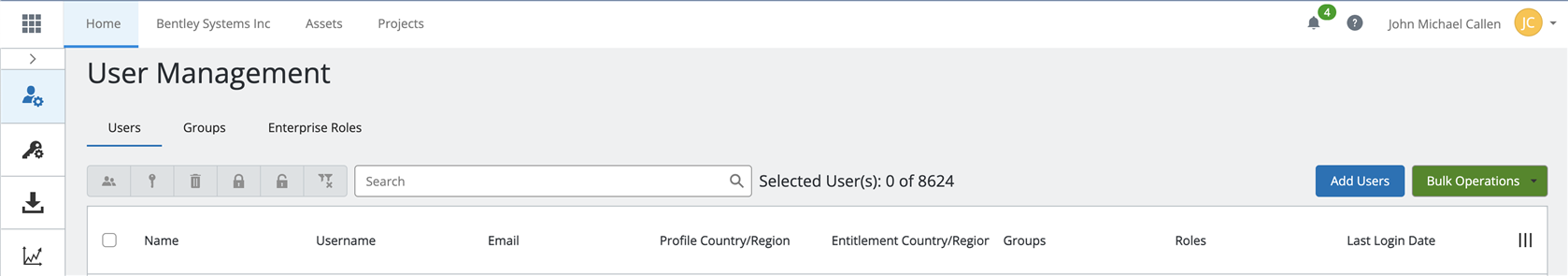

Login to usermanagement.bentley.com or itwiniot.bentley.com.
If logging into usermanagement.bentley.com, you have successfully reached the User Management portal.

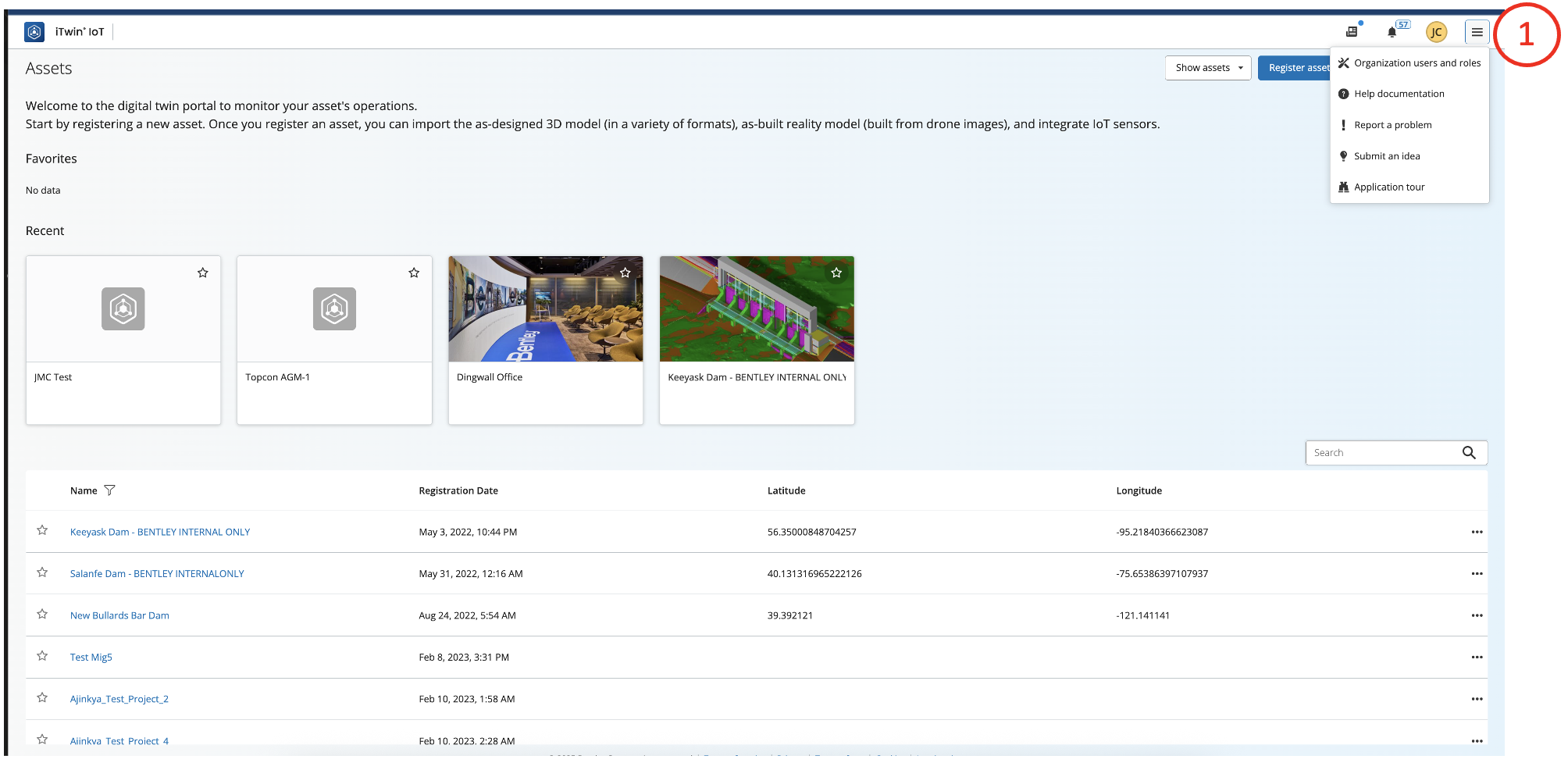

From itwiniot.bentley.com, click the menu bar icon (three horizontal lines) in the upper right corner of the page. Click the "Organization users and roles" button that appears below the menu bar icon.

The User Management page will look like the screenshot below, with organization users listed below the header.

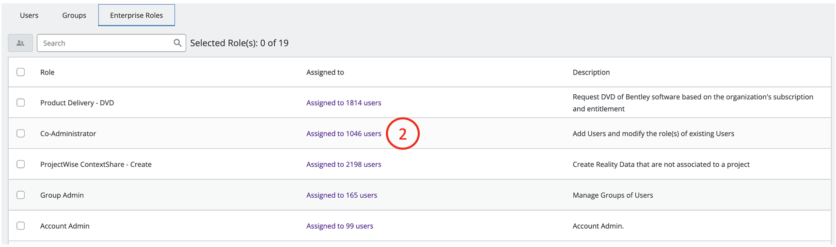

1. User Role Selection- To find users with a certain Enterprise role, click on the "Enterprise Roles" tab.

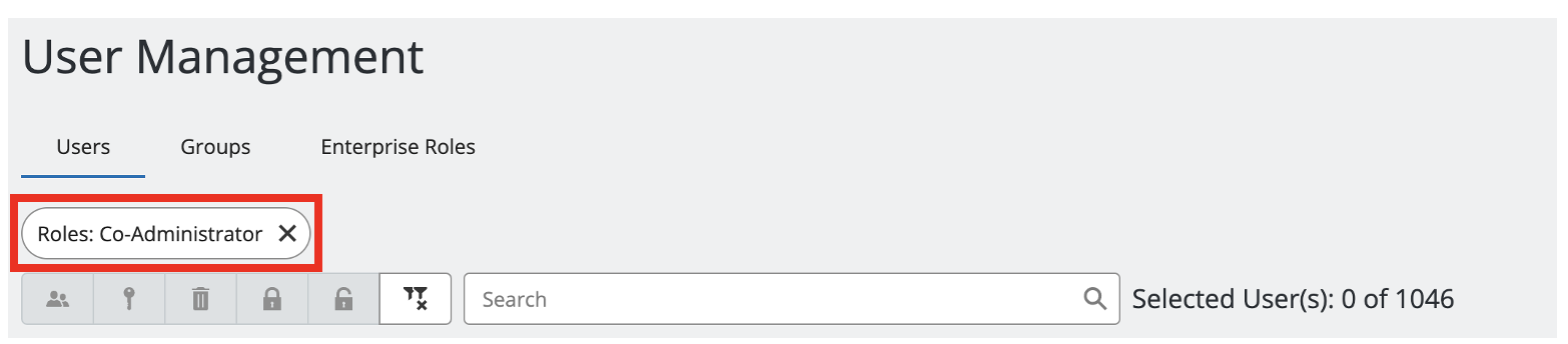

2. Apply User Role Filter- Scroll through roles until finding the role being searched for, and click the "Assigned to xxx users" button.
You will be redirected back to the Users tab of the User Management page. A filter will be visible between the navigation tabs above and the header and list of users below, displaying only users with the selected role in the user table.
