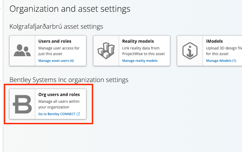

1. Accessing Organization User Management- The Organization level user management portal can be accessed through the menu bar on the top right corner of the iTwin IoT Assets page shown above, and then clicking the "OrgUsers and roles" option.
Take care not to get lost on the Organization User Management page, it is best to only access this page via iTwin IoT and to not use any other features if you only intend to configure users for your Organization
The user will then be directed to the User Management page illustrated below. On this page you can add new users to your Organization and assign Organization-level roles to them. If you are the sole admin of the Organization then it is good practice to add a co-admin or group admin so they can manage the Organization with you. For a description of these Organization roles, please navigate to the Organization Role Description section of this article.

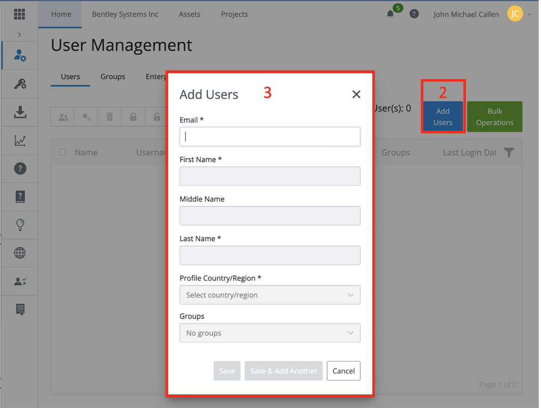

2. Add User- Once on the User Management page, click on the blue "Add Users" button on the right side of the screen. After clicking, a "Add Users" pop-up window will appear in the middle of the screen.
If a user has already been added to the Bentley IMS system but is not assigned to your Organization then you can "claim" the user and add them to your Organization
3. New User Configuration- Fill out the required fields within the new user window, and click "Save" to exit the user configuration or "Save & Add Another" to begin adding another user.

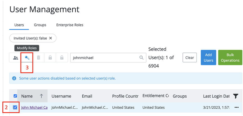

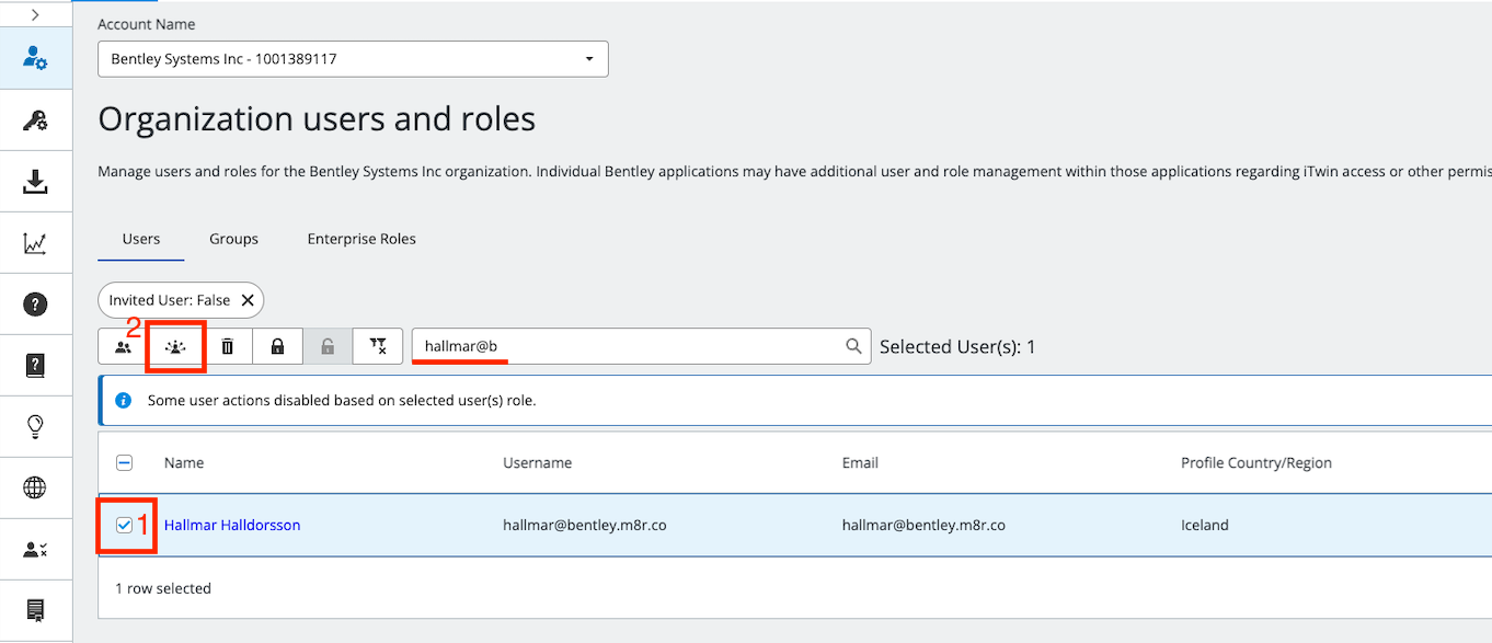

1. User Selection-  Within the User Management page, the user can scroll through the list or use the search bar to find the user they intend to modify roles for. Once the correct user is found use the check mark selection icon next to the user's name.

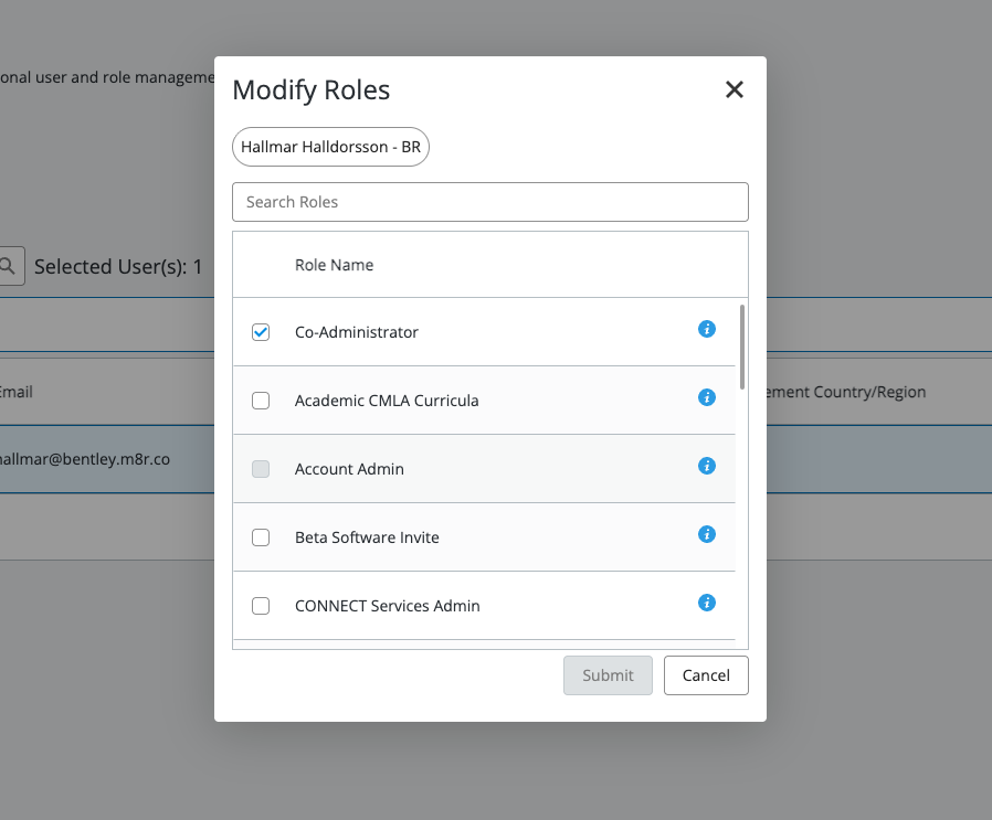

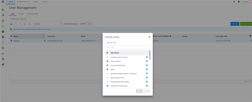

2. Modify Roles- After a user or users have been selected in the step above, the "Modify Roles" icon becomes visible. Click on this icon to open the popout window illustrated below.
3. Modify Roles Window- Select the Organization roles you would like the user to have by toggling the checkboxes in the window. When finished, click Submit.
