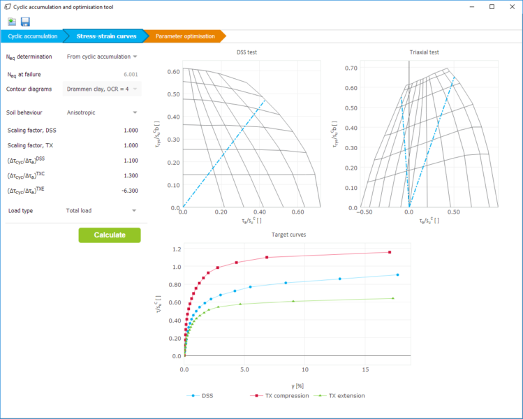

This tutorial illustrates how to calculate the vertical bearing capacity and vertical stiffness of a circular stiff underwater footing (e.g. one of the footings of a jacket structure) exposed to cyclic loading during a storm. The storm is idealised by a distribution of load parcels with different magnitude. The cyclic accumulation tool is used to obtain soil parameters for the UDCAM-S model. The example considers a circular concrete footing with a radius of 11 m, placed on an over-consolidated clay layer.
UDCAM-S: Cyclic accumulation tookl: Stress-strain curves for total load
