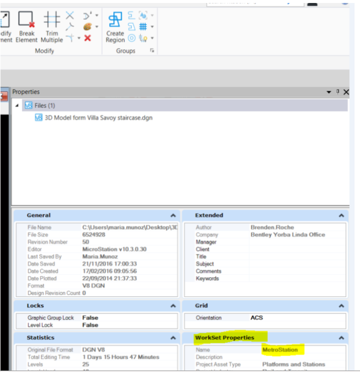

1) Open the design file (will open with the wrong WorkSet associated to it). Once the file opens, you can verify in the Properties dialog which WorkSet was used. See below image:
2) With the design file opened, run the Keyin: file disassociateworkset
This will break the association with that WorkSet (MetroStation in this example).

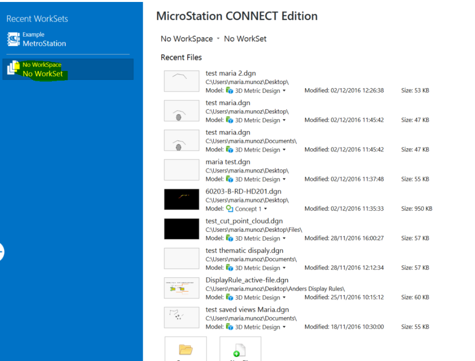

3) Close MicroStation and open the file again.
This time, select the correct Workspace/WorkSet or the No Workspace/No WorkSet if none are used.
Note: You will not get an alert message about the file being associated to the other wrong WorkSet anymore. You can verify this by observing the File Properties to see what WorkSet the file is associated to now.
