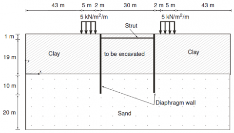

This tutorial concerns the construction of an excavation close to a river. The excavation is carried out in order to construct a tunnel by the installation of prefabricated tunnel segments. The excavation is 30 m wide and the final depth is 20 m. It extends in longitudinal direction for a large distance, so that a plane strain model is applicable. The sides of the excavation are supported by 30 m long diaphragm walls, which are braced by horizontal struts at an interval of 5.0 m.
