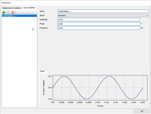

In this tutorial, the influence of a vibrating source on its surrounding soil is studied. To reduce the calculation time, only one-quarter of the overall geometry is modelled, using symmetry boundary conditions along the lines of symmetry. The physical damping due to the viscous effects is taken into consideration via Rayleigh damping. Also, due to radial wave propagation, 'geometric damping' can be significant in attenuating the vibration.
The modelling of the boundaries is one of the key points in the dynamic calculation. In order to avoid spurious wave reflections at the model boundaries (which do not exist in reality), special conditions have to be applied in order to absorb waves reaching the boundaries.
