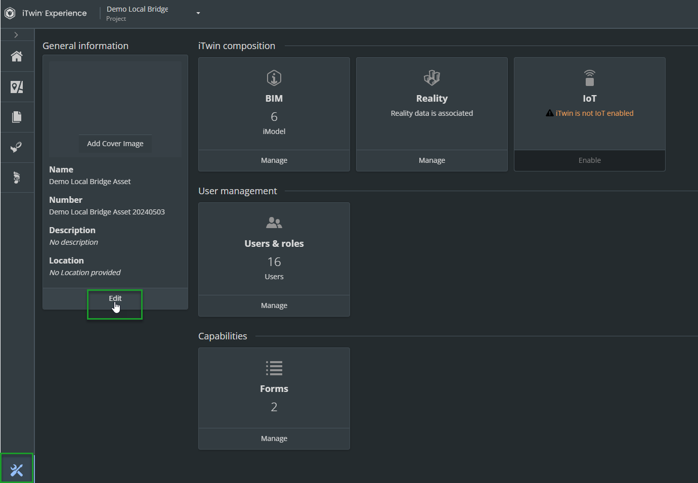

Configure Asset
Once you have created your asset, you can modify the configuration at any time by clicking on the "Configure" button located on the bottom left side of the iTwin Experience page.
For more information, consult the Asset Configuration section.
Edit Asset
At any time, you can edit the asset by clicking on the Asset Contiguration page located on the iTwin Experience page and click on the Edit button.
Delete Asset
To delete an asset, go to the Asset Configuration page, click on the Edit button as described in the previous section and click on the Delete button.

Configure Project
Once you have created your project, you can modify the configuration at any time by clicking on the "Configure" button located on the bottom left side of the iTwin Experience page.
For more information, consult the iTwin Administration section.
Edit Project
At any time, you can edit the projectby clicking on the Project Contiguration page located on the iTwin Experience page and click on the Edit button.
Delete Project
To delete a project go to the Project Configuration page, click on the Edit button as described in the previous section and click on the Delete button.
