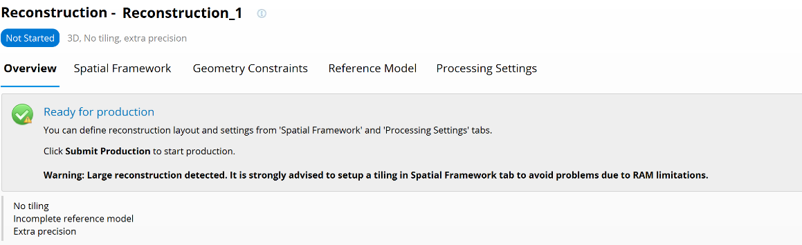

In ContextCapture, when creating a new reconstruction, a warning appears if the block contains a large quantity of data.
In that case we recommend using tiling

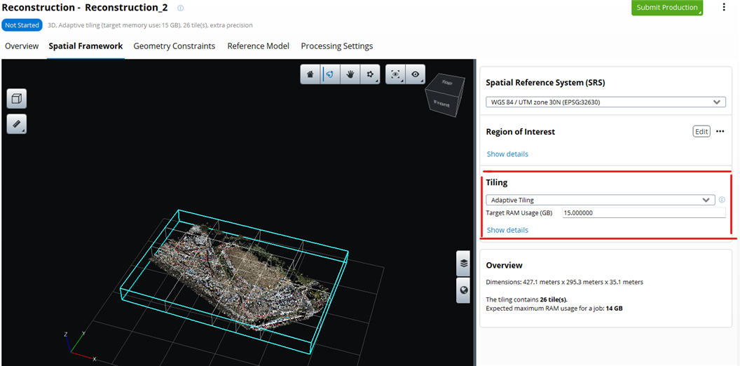

The Tiling setup mode options are accessible from the “Spatial Framework” tab of your reconstruction.

Adaptive tiling
Adaptive tiling will be defined based on the maximum RAM you want to allocate to your ContextCapture Processing.
The tiling will be automatically generated so that no tile should require more RAM than the defined limit.
This type of tiling results in an optimized size and distribution of the tiles. It is recommended for projects for which the resolution can dramatically change (with the addition of close-ups for example), or for project in full 3D such as buildings, towers, bridges, etc.
Error message
If the tiling is not correctly set, or the RAM estimation is too big for your computer, the following error message may appear: “Insufficient memory for processing. Please adjust the processing settings or reduce the size of your data. [insufficientMemory]”
If you are getting this error, we recommend adding tiling or reducing the tile size as mentioned.
