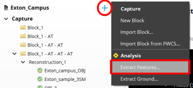

1. Start the feature extraction workflow using the “plus” icon in your project tree view and click “Extract Features”

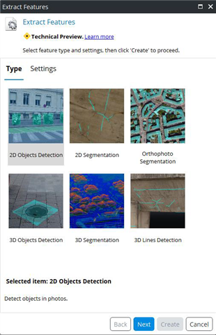

2. Select your feature extraction type.

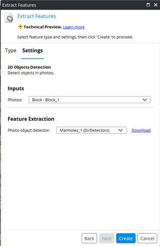

3. Select the input data, the detector to be used and additional settings when required.

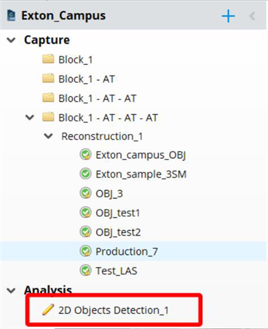

4. Press "Create”, this will add a new “analysis item” in the project tree view

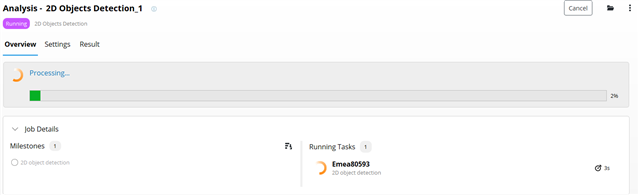

7. Review the progress in the Overview tab

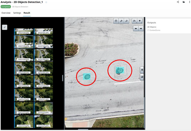

8. Go to the “Result” tab to visualize your results when processing is complete. Results will show in 2D or 3D views depending of the type of outputs generated.
