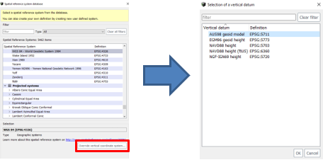

- When creating a new control point or importing images positions you will access the coordinate system selection window
- Select the X,Y coordinate system you want to use then select the Override vertical coordinate system… button
- Select the desired height geoid grid
