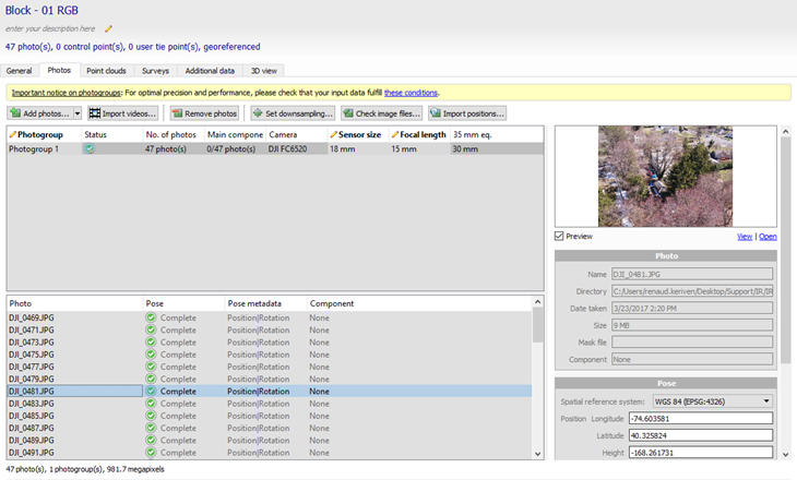

Create RGB Model
- Create a first block with RGB images
![](43c9898797b60e1036d5f33ef053af1e.iix)

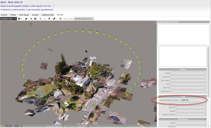

Process RGB Aerotriangulation (AT)
- Take note of the Spatial reference system

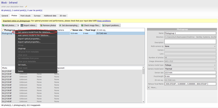

Create Infrared Model
- Create a block with IR images

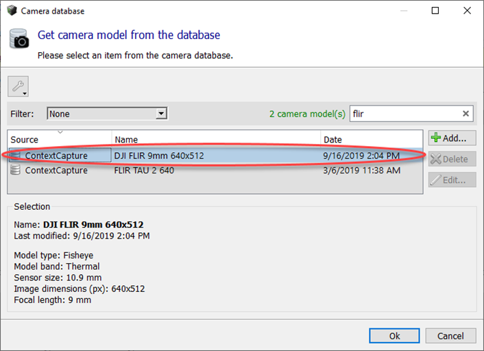

- If the camera is not recognized, right click on Photogroup and select Get camera model from database
![](4bc94d8797b60e1036d5f33ef053afbb.iix)
- Search for FLIR and select DJI FLIR 9mm 640x512
![](5bc94d8797b60e1036d5f33ef053afbd.iix)

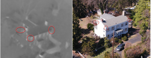

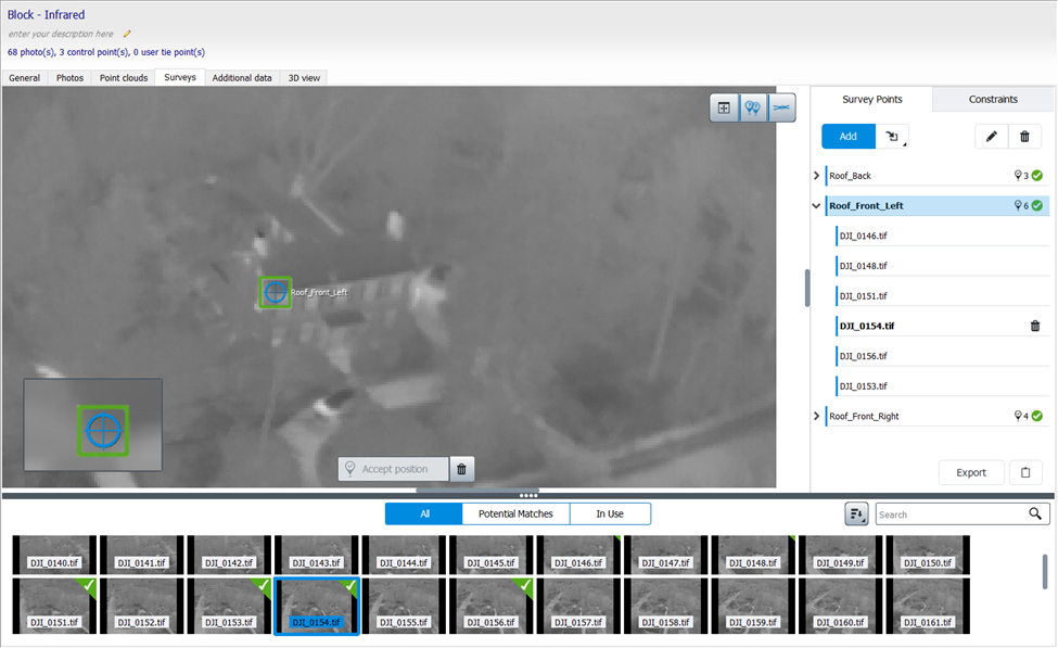

- Examine your infrared images and find 3 locations that can be identified. For example, in this project, we can choose 3 corners of the roof line.
- For now, you are just thinking about the locations and will define them later
- Corners of pavement and grass also work well
![](5bc94d8797b60e1036d5f33ef053afbf.iix)

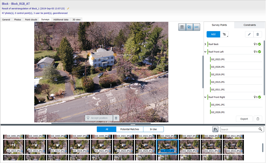

Add Tie Points
- Add 3 user tie points and define them in at least 3 RGB images for each one.
![](5bc94d8797b60e1036d5f33ef053afc1.iix)

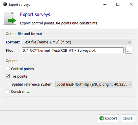

- Export the points a text file
![](93c94d8797b60e1036d5f33ef053afd0.iix)

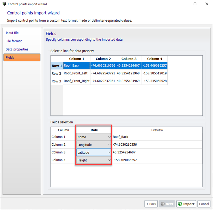

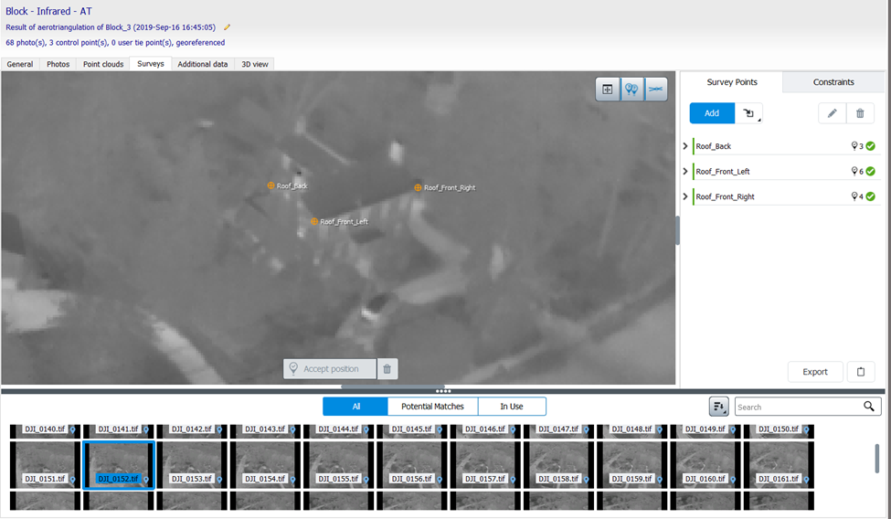

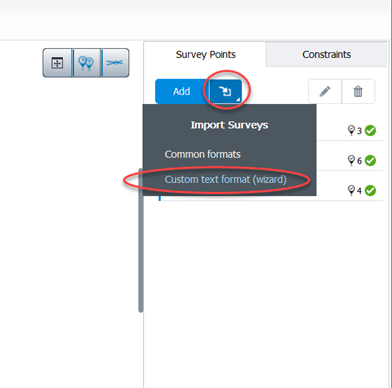

Create Survey Points
- Create Survey Points from previously exported User Tie Point
- Now within your Infrared block, Select the Survey Tab

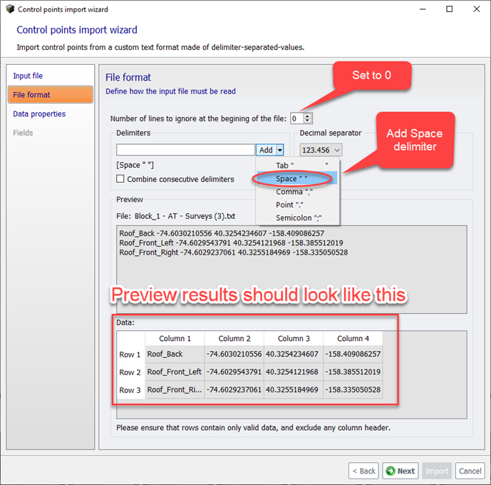

- Import The Survey Points that you create from your RGB block using the Custom text format wizard.
![](93c94d8797b60e1036d5f33ef053afd2.iix)
![](93c94d8797b60e1036d5f33ef053afd4.iix)

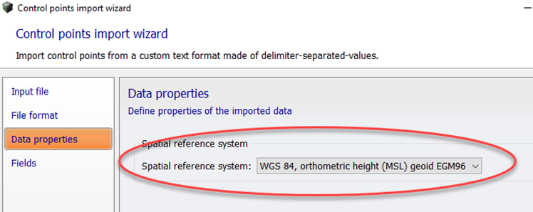

- Set Spatial reference system to WGS 84, orthometric height (MSL) geoid EGM96
![](93c94d8797b60e1036d5f33ef053afd6.iix)
- Define each column as shown
![](93c94d8797b60e1036d5f33ef053afd8.iix)
![](93c94d8797b60e1036d5f33ef053afda.iix)

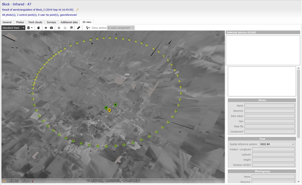

- and run AT with positioning mode 'Use Survey Points for rigid registration.'
![](13c94d8797b60e1036d5f33ef053aff7.iix)

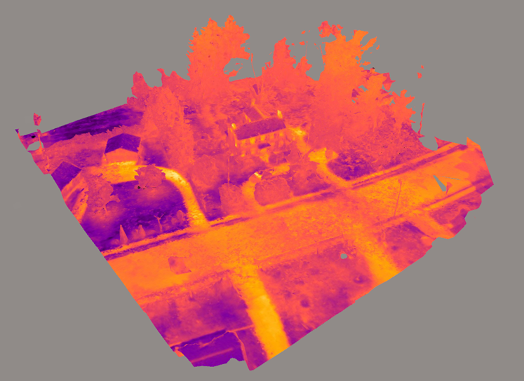

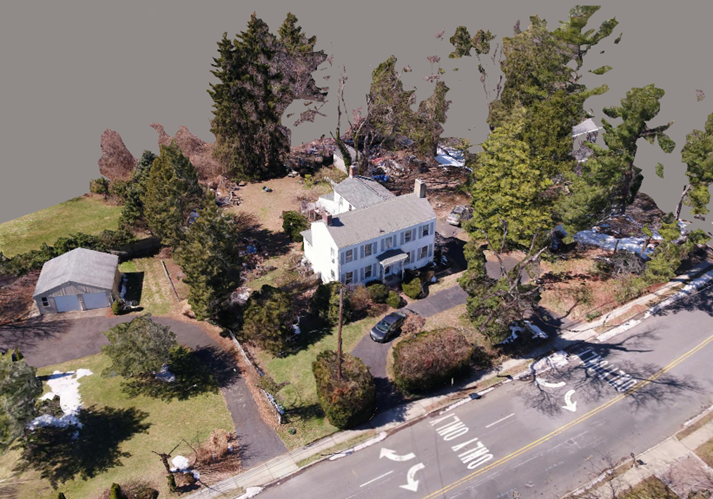

Create a reconstruction and produce two meshes: one textured with visible colours, the other one with thermal imagery
![](13c94d8797b60e1036d5f33ef053aff9.iix)
![](93c94d8797b60e1036d5f33ef053affb.iix)

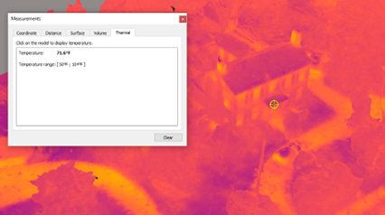

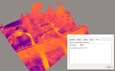

Measure Temperature
- Measurements: since colour equalization did not alter thermal images, their original grey level, from 0 to 255 is preserved. The measurement tool of the viewer can display this level:
- So far, ITwin Capture Modeler does not know how to convert these values into a real temperature. This conversion depends on the camera vendors and models. If there exist a known affine transformation between these values and real temperature, one can manually edit the metadata.xml file located in the production to define this relationship.
- This metadata.xml file will be used by ITwin Capture Modeler Viewer which will modify the way it displays temperature.

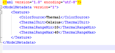

Settings for Celsius

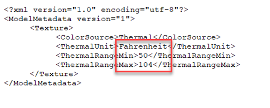

Settings for Fahrenheit
