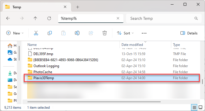

  1. Locate the Windows temporary folder in your computer that contains the files of this project. Typically, this can be found by opening a Windows Explorer folder and typing: %temp% (and press Enter). See Figure 2 for an example.
    Figure 2: Location of temporary folder.
  2. Within this folder, find the folder named Plaxis3DTemp for PLAXIS 3D projects, or PLAXIS2DXTemp for PLAXIS 2D projects. (highlighted in Figure 2).
  3. Open this folder and copy all the contents except for the "XX" file(s), shown in the "Details" of the save failure window.
  4. Create a new folder on the desktop with the name: Plaxis3DTemp (or PLAXIS2DXTemp) and paste all the copied files into this folder.
