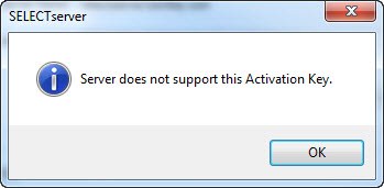

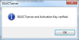

8. Once you have provided the Server name and Activation key, Click Test Connection. You should get this message
BUT if you get this message:
Double check the activation key, there should be no spaces before or after. If you have verified you have entered it correctly and still getting the same error please call the Technical Support hotline. You can't proceed with the product activation.
9. Once the Select Server and Activation key is verified Click NEXT

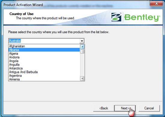

10. Select Country. Click NEXT
