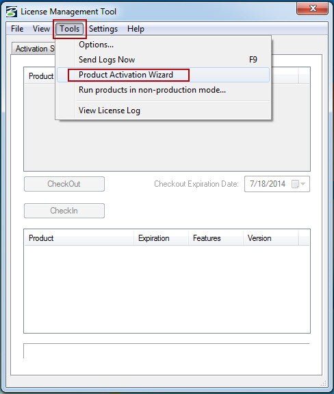

4. Now you need to open the License Management Tool to Activate the product.
5. The License Management tool will open. Then go to > Tools > Product Activation Wizard

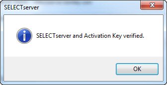

8. Once entered the Activation Key, Click Test Connection. You should get this message
BUT if you get this message:
Double check the activation key, there should be no spaces before or after. If you have verified you have entered it correctly and still getting the same error please call the Technical Support hotline. You can't proceed with the product activation.
9. Once the Select Server and Activation key is verified Click NEXT

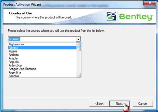

10. Select Country. Click NEXT

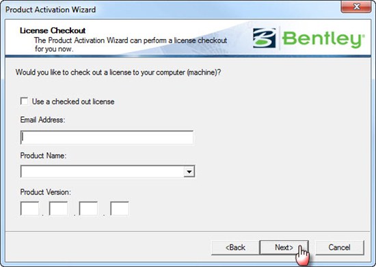

11. The following screen is titled "License Checkout". Please note that using a checked out license is only intended if you will be without an internet connection for an extended period of time. If you will be connected to the internet at most times, a checked out license is not needed, and you can Click NEXT.
12. The next page will show you a summary of the information you have entered. Click Finished
