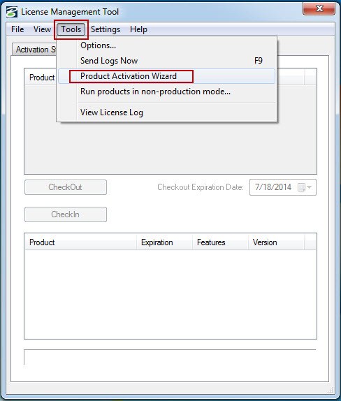

4. Now you need to open the License Management Tool to Activate the product.
5. The License Management tool will open. Then go to > Tools > Product Activation Wizard

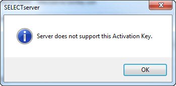

8. Once entered the Activation Key, Click Test Connection. You should get this message
BUT if you get this message:
Double check the activation key, there should be no spaces before or after. If you have verified you have entered it correctly and still getting the same error please call the Technical Support hotline. You can't proceed with the product activation.

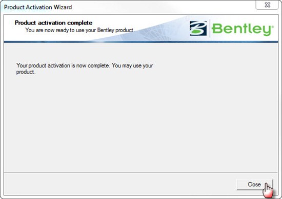

13. Product activation is now complete. You may use your product/
Click Close.
