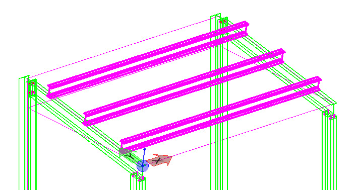

  2. For theĀ purlin connection it is possible to create more than one connection at the same time.
    Hold the Control key and select all three purlins.

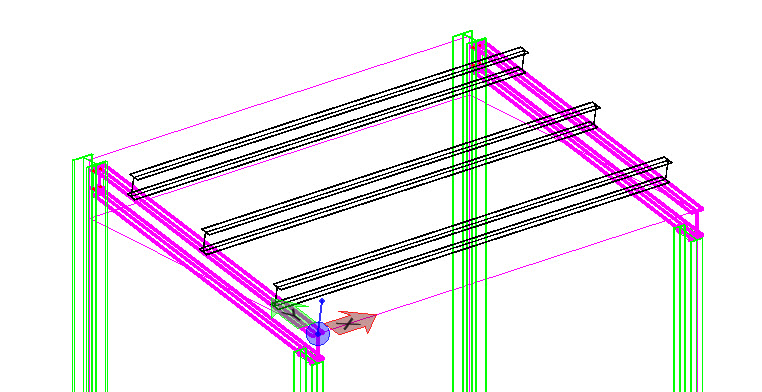

    After a left click to confirm the selection hold the Control key again and select both roof beams.
    After another left click the connections should be created and the dialog appear.

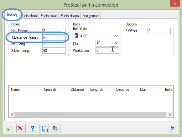

  3. The tab Bolting should be selected.
    For the bolt distance there is an automatic to use "w" for getting the distance from the shape pitch lines.
    After leaving the distance field with "w" as value the correct distance should appear. We do this for both, 1. and
    2. distance. Using "w" is possible for all hole distances in ProSteel dialogs.
